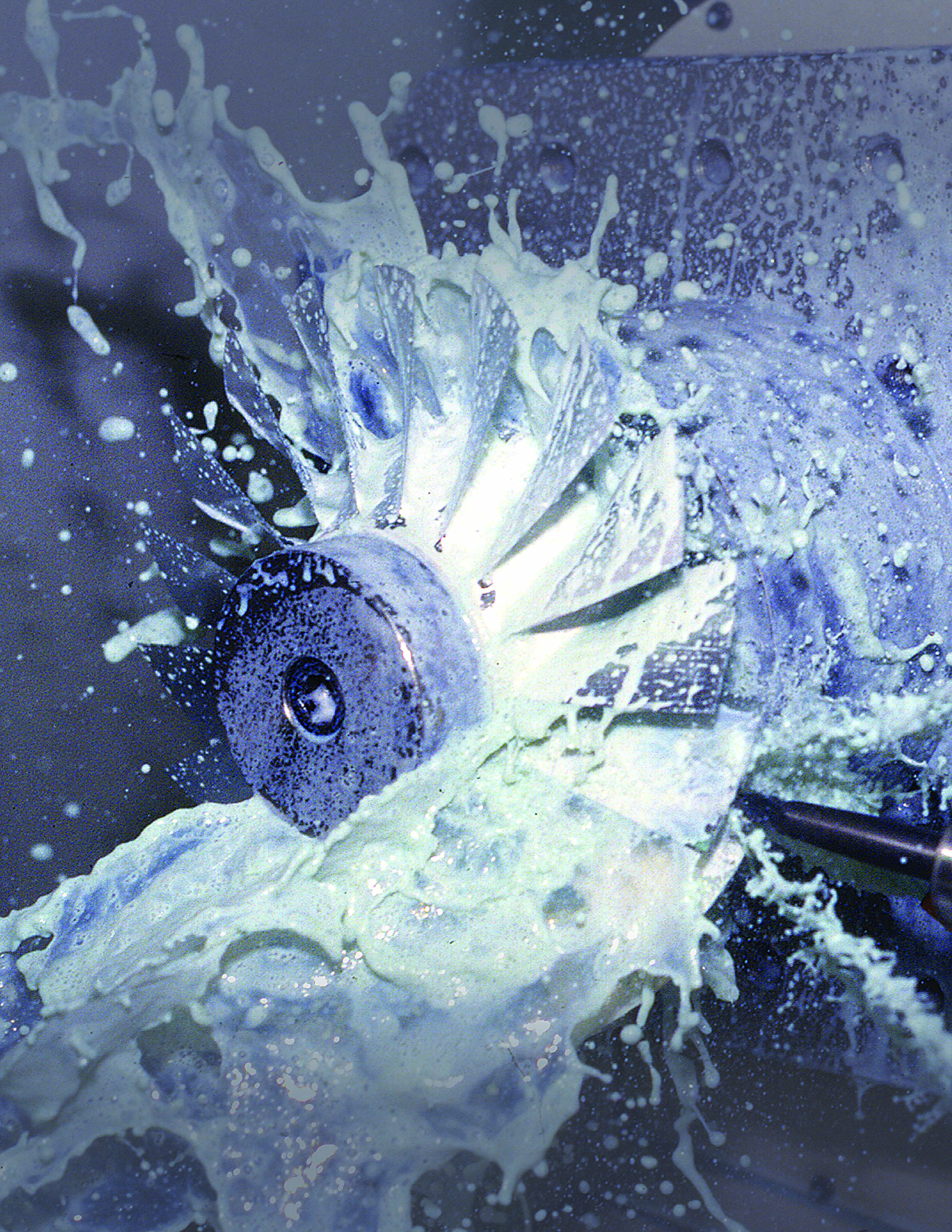

Production of critical aerospace components, such as this blisk, requires machine tools with high volumetric accuracy.
