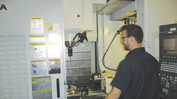

SAM_0447.tif
Joel Johnson, team leader for machining in the combustion shop, prepares to run a program created by Rocco Versace on an Okuma VMC.
