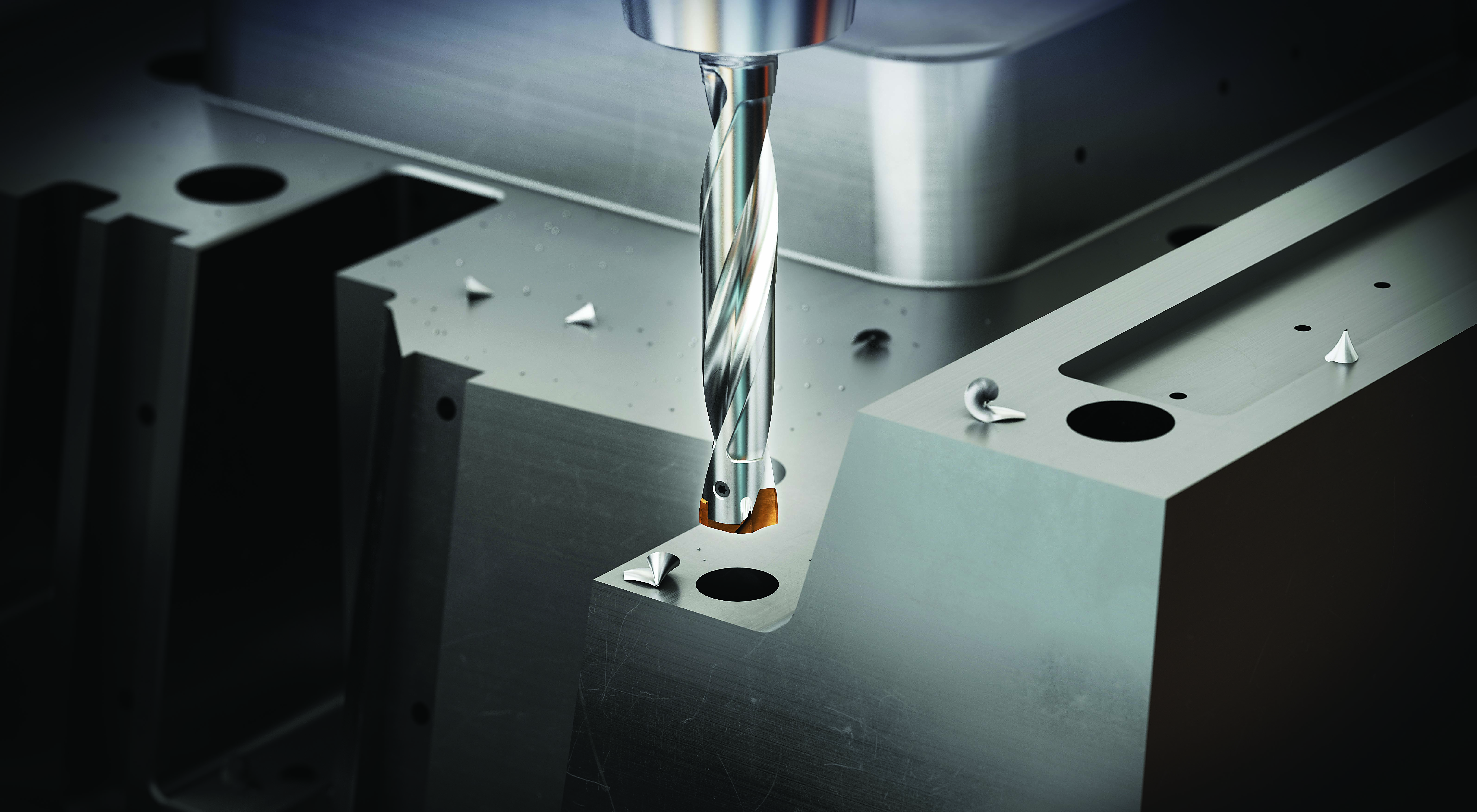

Rutkowski, who also sees numerous agricultural applications for ADI, said successfully drilling the material requires controlling chip formation in addition to evacuation.
“You know you have it right when chips are just marching right out of the hole,” he said.

The correct geometry starts with the drill point, which must be conical so the drill will center itself, Rutkowski said. He said having polished flutes, double margins and an embellishment, such as a chamfer form C, on the outer face of the cutting edge is paramount for high-performance drilling.
Pilger said the flutes should have a 30-degree angle or greater.

“We have to make sure the spiral is at the right angle,” he said, “and more importantly has the correct spacing to remove that material at the speeds and feeds that you run at.”
Pilger said that flute configuration is found in YG-1 Tool’s Dream Drill General and MQL drills.
Another option from the toolmaker is its modular i-One drill, which has an exchangeable, double-effective carbide head, he said. The drill is suitable for producing large-diameter holes, starting at about 19 mm (0.75″).

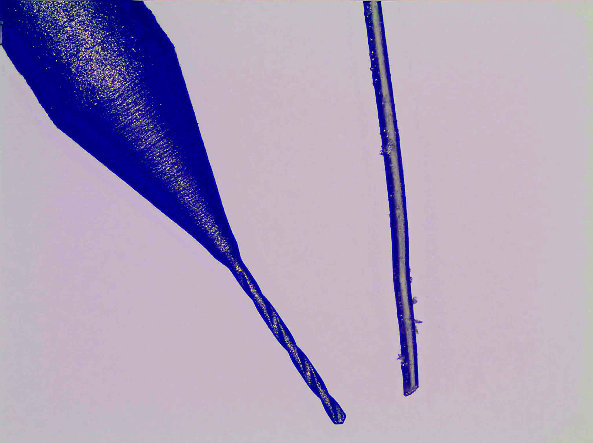

The 0.05-mm-dia. carbide drill with a 12-µm-thick multi­layer diamond coating is displayed next to a human hair. Image courtesy of GCT
Shine On, You Multilayer Diamond
GCT GmbH announced that it has deposited a 12-µm-thick (0.00047″) multilayer diamond coating onto a 0.05-mm-dia. (0.002″) carbide drill. The tool is applied specifically for drilling ceramic workpieces, said Martin Vogler, managing director of the Weingarten, Germany-based company.
He said the carbide drills are from select German suppliers and produced to GCT’s specifications. The company provides coating services and typically sells diamond-coated tools for ceramic applications.
Vogler said GCT has seven chemical vapor deposition coating devices and has coated about 1.2 million cutting tools, including carbide ones for graphite, composite and ceramic applications. The industries served include dental and electronics.
