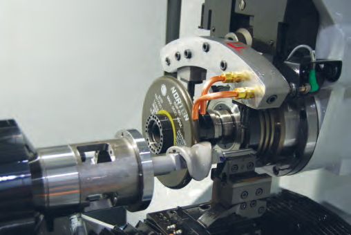

Because multiaxis tool and cutter machines can grind complex contours using CAD/CAM software, many shops use the machines to produce medical parts, such as this component of an artificial knee.

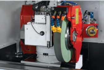

The wheelhead of the Studer S33 universal grinder has two motor spindles for external grinding as well as an internal grinding attachment. Coupled with manual or automatic swivel capabilities, the wheel arrangement allows users to grind multiple features in one clamping.
Studer designed the wheelhead of the S33 universal grinder to minimize interference. The wheelhead has two motor spindles for external grinding and an internal grinding attachment. Manual or automatic swivel capabilities permit external and internal grinding in one setup. The arrangement, Ueltschi said, “gives the most flexibility in many scenarios. This wheel arrangement allows the user to do more features in one clamping.”

Grinding machines with increased flexibility are also allowing shops to enter new markets. “It comes down to having the axes and software,” said Russell Riddiford, president of ANCA Inc., Wixom, Mich. The growing market for medical tools and components is a prime example. In the past, Riddiford noted, machines that ground medical parts and surgical reamers and drills were designed specifically for those tasks.
“Years ago, you wouldn’t think of a CNC tool and cutter grinder making a hip rasp. It would be a special-purpose grinding machine,” he said. Now, because multiaxis tool and cutter grinders using CAD/CAM software can produce complex contours, many shops are acquiring tool and cutter grinders to produce medical parts (see photo on page 43).
Riddiford said a major factor influencing that trend is the move by many medical part designers to standardize on the Siemens PLM NX CAD modeling package. “The medical companies will provide a model, which has parameters of the shape they want manufactured,” he said. “Companies like ours will pass that NX model through a converting tool to create ANCA control language or other CNC language, and then that generates the software paths for what you want to grind.”
The main driver for adapting standard machines to grind special parts, Riddiford said, is shops don’t want to invest in a special-purpose machine dedicated to grinding just one part. “That part may not be around after a period of time,” he said. “Buying a multiaxis CNC tool and cutter grinder with optional software that can do these rasps and cutters is a much better investment, because if that work goes away, you have the software on the machine to do something else. Or you can just convert it back to a tool and cutter grinder to cut endmills.”

Courtesy of United Grinding
In peel grinding, shown here in a shaft-grinding application on a Studer S22 machine, a CNC-guided narrow grinding wheel moves in a traverse path across a part. Peel grinding permits grinding of different shapes with the same wheel by changing the program, not the wheel.
