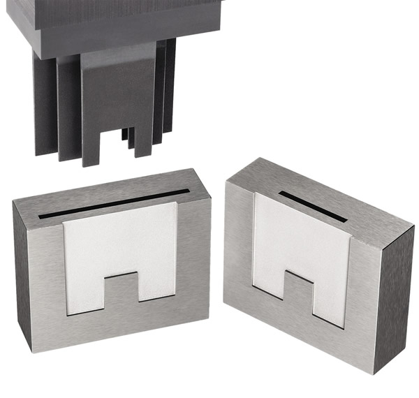

Unique to sinker EDMing, HyperCut technology can be utilized with any electrode and does not require additional changes to electrode reduction to significantly reduce cycle time. The technology is able to apply more power to the electrode to improve machining speeds while not changing the overburn amount and resulting part size and surface quality.
