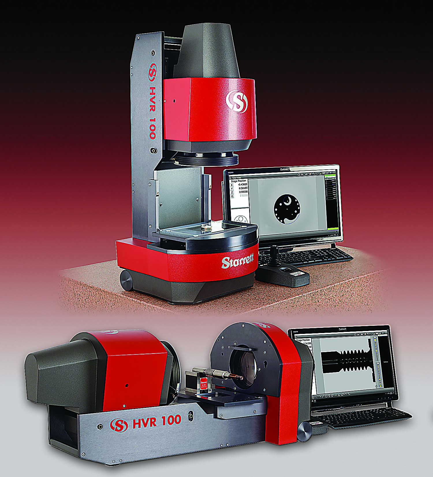

Greg Maisch, product development manager for Starrett Kinemetric Engineering, measures a part on the company’s new HVR100-FLIP benchtop vision measurement system, which can also measure parts in the horizontal orientation. Image courtesy of Starrett Kinemetric Engineering.

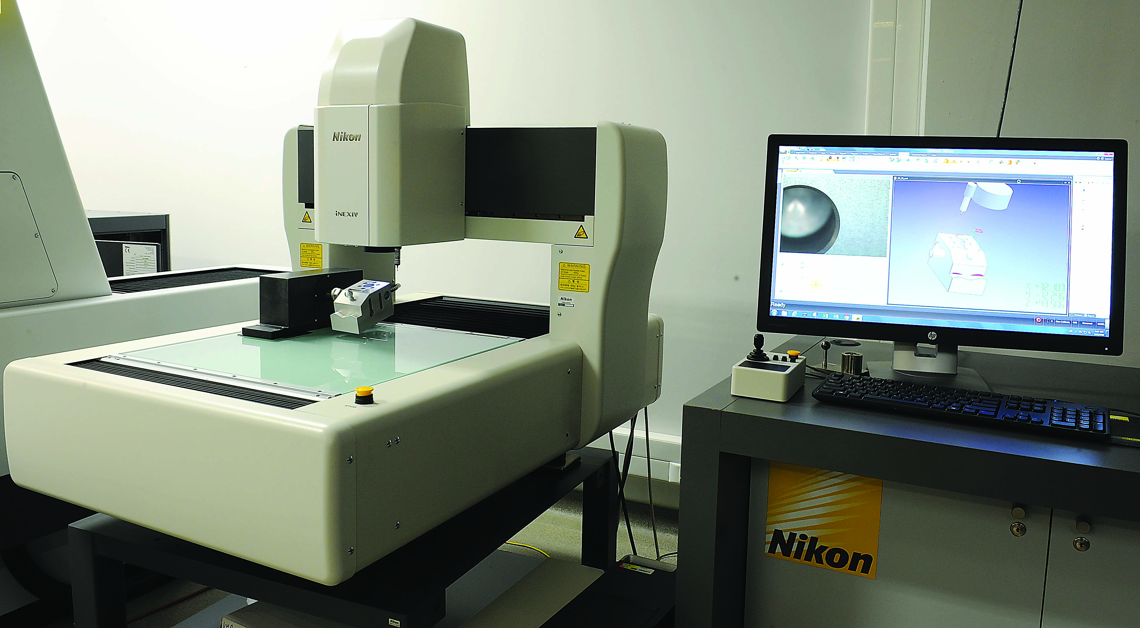

The addition of a rotary indexer on the VMA-4540 vision machine enables parts to be rotated into the field of view. Image courtesy of Nikon Metrology.

While flat parts are better-suited for measuring in the vertical orientation on the HVR100-FLIP vision system, the horizontal orientation works better for threaded parts. Image courtesy of Starrett Kinemetric Engineering.

Another best-of-both-worlds offering from Starrett is the HVR100-FLIP benchtop vision measurement system. It features a high-resolution digital video camera that minimizes optical distortion for accurate field-of-vision measurements up to 90mm (3.54″). While video measuring machines typically provide a vertical viewing format and most comparators have a horizontal format, the HVR100-FLIP can measure parts in both formats.
Maisch explained that when the part to be measured requires extensive fixturing, the horizontal format is more suitable. Examples are turned parts, such as camshafts and any kind of threaded part.
“Your fixturing can be a little taller, and you don’t have to worry about the lens being above your part,” he said.
On the flip side, Maisch said the vertical orientation is better-suited to measuring flat parts, such as ones that were laser- or waterjet-cut, and parts with pockets. It’s important that the part is extremely square to the camera, he added.
The stages are square on the horizontal format, but the fixturing must also be square. It can take considerable effort to achieve square fixturing, especially for fixtures that a shop produces, which sometimes makes the vertical option more attractive.

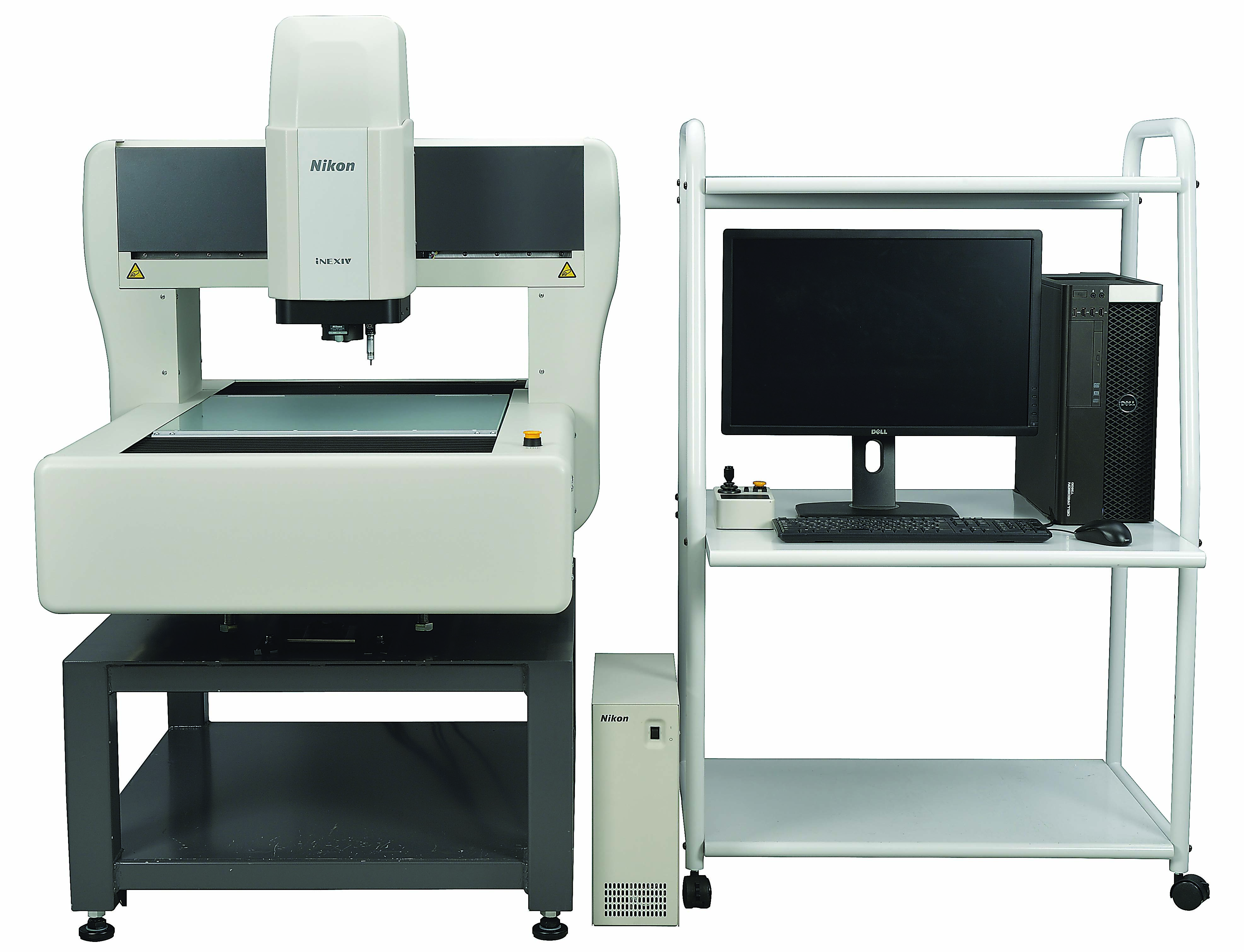

The VMA-4540 vision machine from Nikon Metrology has a measuring envelope of 450mm × 400mm and a 200mm Z-axis stroke. Image courtesy of Nikon Metrology.
Another option on some DVM machines is a laser for automatic camera focus, but it should be universal, Provenzano said. “I really feel that every vision machine should have a laser,” he said. “I just don’t understand why people buy vision machines without a laser.”
He conceded that initially some people want to save a bit of money, but the enhanced functionality and ease of use a laser provides quickly cover that cost. Nikon’s high-end vision machine comes integrated with lasers, Provenzano added.

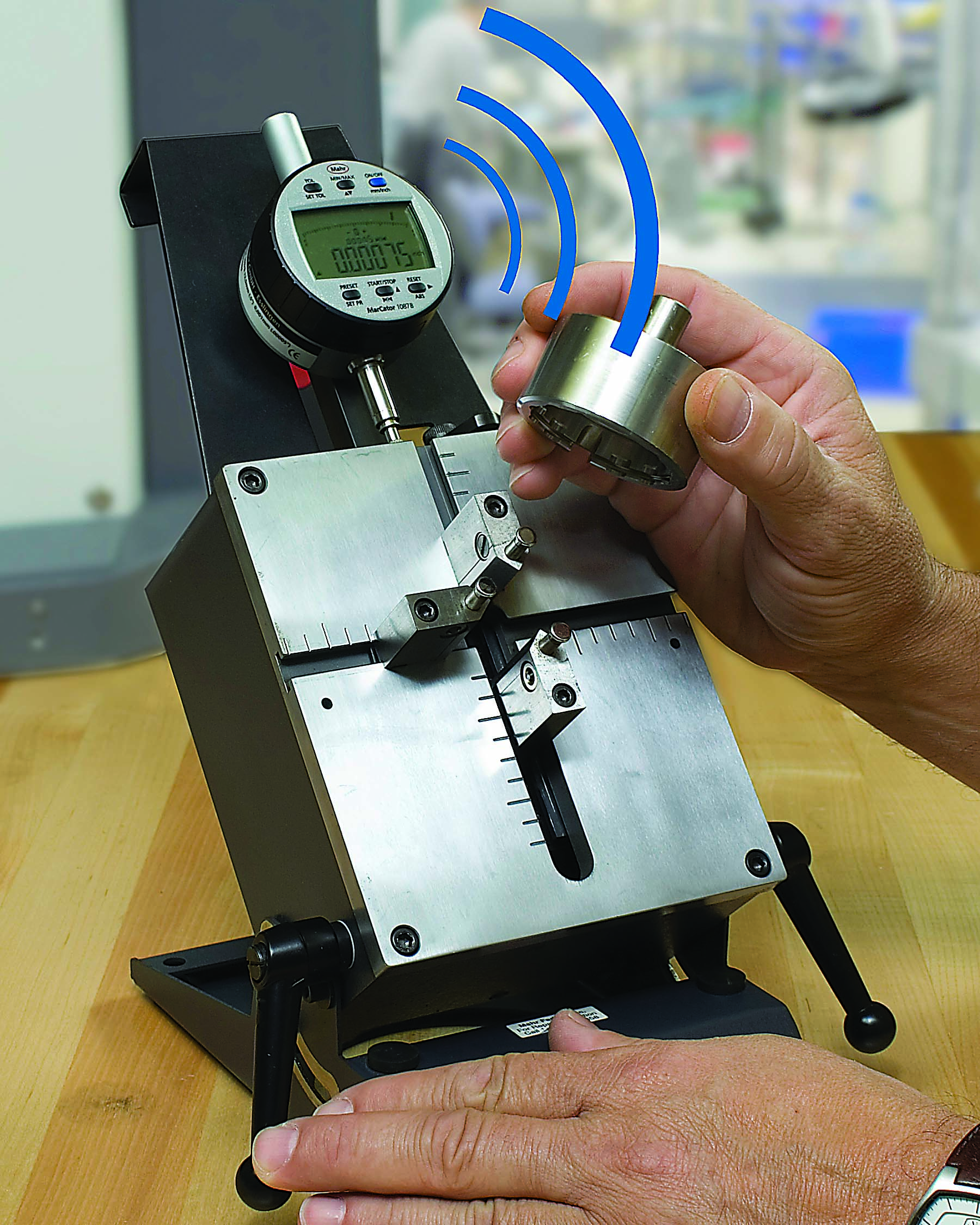

One method for simplifying part measurement is with integrated wireless data transmission. According to George Schuetz, Mahr Inc. offers calipers, digital indicators, depth gages and micrometers that feature wireless technology, so there are no add-on interface boxes or additional batteries, and data transmission is transparent to the operator.
“He can make his measurements, collect data and it’s all part of his measuring process,” Schuetz said. “There’s nothing special needed to do that.”
Advancements in digital vision systems make measuring parts simpler, more repeatable
Mahr’s Multimar 36 B indicator gage accepts a Mahr integrated wireless indicator for wireless data transmission. Image courtesy of Mahr.
In addition, taking measurements on the shop floor and transmitting them wirelessly speeds the quality-assurance process, he said. “It also adds flexibility and a measure of safety by eliminating troublesome cables. This speeds setup and provides more efficient data processing, especially for quality control in production or incoming-goods inspection.”
By touching a button on the measurement instrument, acquired data is transmitted from the gage to an i-Stick radio receiver plugged into the USB port of a computer, the company reports. With Mahr’s MarCom Pro 5.2 software, measured values from connected devices can be automatically transferred into separate Microsoft Excel columns, tables or files, or via a keyboard code into any Windows program or existing statistical process control application.
