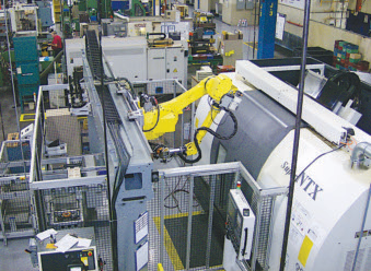

Kennametal uses Nakamura-Tome Super NTX mill/turn machines with robotic material handling from Methods Machine Tools to produce toolholder blanks at its Solon, Ohio, facility.

Machine tool supplier Methods Machine Tools Inc., Sudbury, Mass., challenged the original plan. “Methods proposed using just four mill/turn systems instead of the six or eight mill/turn systems we had originally planned to buy. The proposal was highly productive and economical,” Stanko said.
Methods recommended producing the blanks with Nakamura Tome Super NTX mill/turn machines with robotic material handling. The machine has its tool spindle on the upper side and two turrets on the lower side. With its B-axis automatic toolchanger capability, including the unique configuration of two lower turrets, the Super NTX allows three tools to cut simultaneously. By using the two lower turrets during the tool change, idle time is reduced.
The Super NTX also has an integrated recipe management system. This allows the operator to program and save a new style of blank by specifying the diameter, length and end connection for the blank so it can be recalled later.
Once the systems are set up, they run minimally attended. Through the use of a vision system and laser measurement, the robotic material handling system ensures the proper raw materials are being presented to the machine. One operator services two systems, performing quality audits, feeding materials and removing finished blanks.
