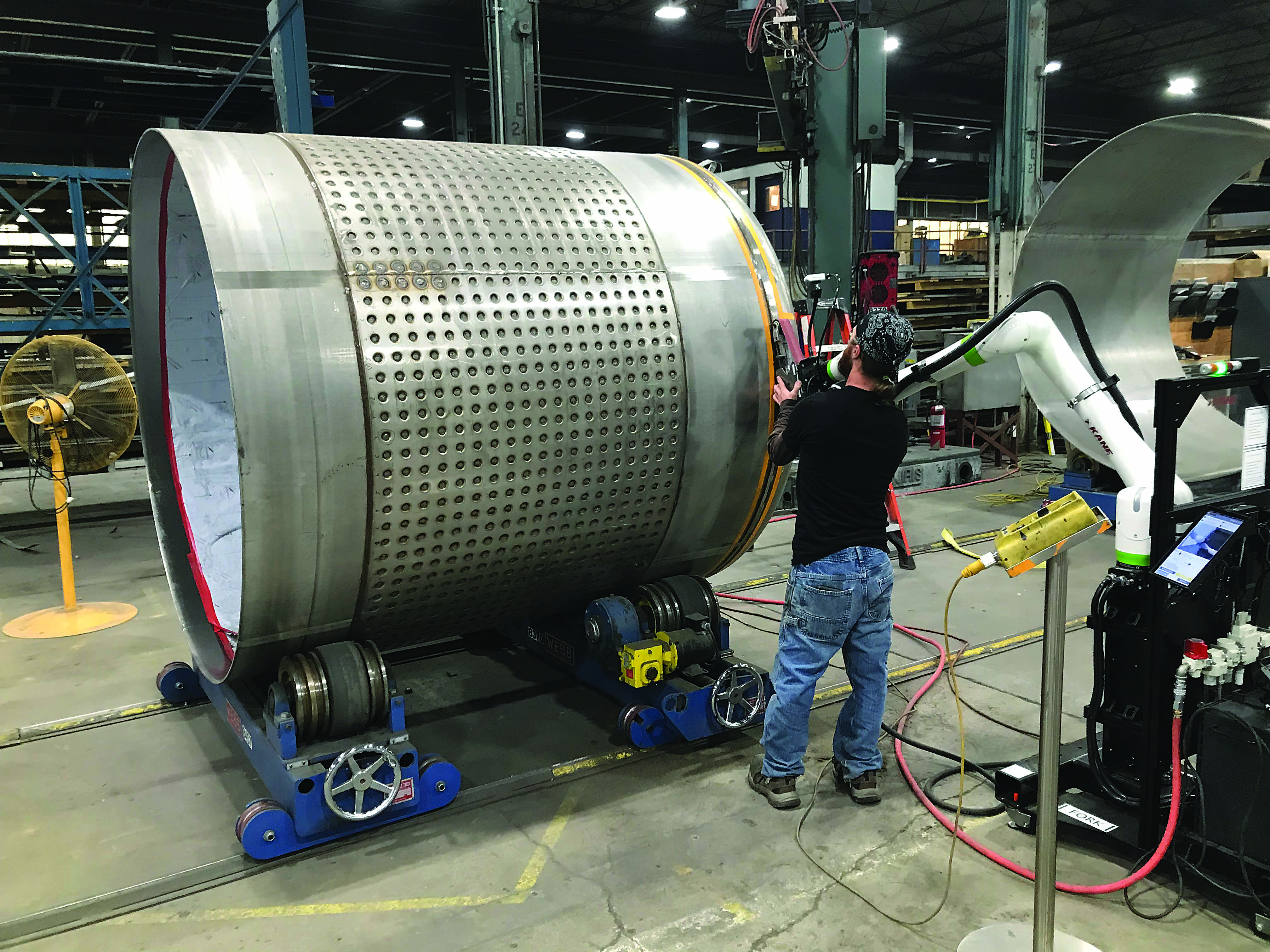

After welding steel tank parts together, a technician manually grinds the weld seams with a heavy, handheld tool to impart a smooth finish. For long welds on the tanks, which measure 3.66 m to 6.10 m (12′ to 20′) in diameter, this activity is time-consuming and grueling. Workers often suffer shoulder, wrist, back and neck injuries and fatigue, causing downtime and high turnover.
The company sought a more sustainable method for weld grinding and turned to Kane Robotics Inc., a leading developer of cobots based in Austin, Texas. Kane Robotics offers a mobile and versatile GRIT cobot that combines a robotic arm with a variety of end-of-arm tools that are preprogrammed to perform various types of material removal tasks, including metal grinding. The integration of the cobot into Paul Mueller’s manufacturing line reportedly offered Kane Robotics an opportunity to not only demonstrate the cobot’s ability to improve efficiency and safety, but also to test and perfect the company’s new GRIT Vision System. The proprietary AI-powered visual system incorporates cameras and machine learning software to teach the cobot to follow a weld seam or other uneven surface while grinding, sanding or polishing.To incorporate the cobot system into Paul Mueller’s tank fabrication processes, Kane Robotics engineers first introduced the GRIT. The cobot easily integrated into the assembly line with its 110-volt electrical connection and flexible configuration. Kane equipped the robotic arm with an end-of-arm tool purpose-built for weld grinding, and preprogrammed the cobot to apply the appropriate speed and force over the correct area and duration to grind weld seams on the tanks.Kane Robotics reports that its engineers quickly taught human operators to configure the cobot. Because most of the programming was already done, technicians only had to learn a few simple commands on the user-friendly interface. Installation was complete in a matter of hours, with the system up and running within days.A technician at Paul Mueller Co. manipulates the AI vision-equipped cobot from Kane Robotics to grind a weld seam on a stainless steel tank. Image courtesy of Kane Robotics
GRIT had already been proven to double weld-grinding efficiency in other use cases. The installation at Paul Mueller offered an additional benefit, as the vision system could make automated grinding even more accurate by tracking uneven weld seams and redirecting the robotic arm accordingly. The advanced vision system includes a camera attached to the cobot’s arm. A human operator positions the camera, and then the AI software performs live object detection on the weld seam.
The camera captures dozens of frames per second as the weld seam passes by on one of Paul Mueller’s rotating tanks. The camera moves slightly left and right, following the imperfect seam, and the software automatically recalibrates the robotic arm’s movement to direct the weld-grinding tool along the correct path.

The intelligent system learns to see the varying weld seam even as it disappears, as it has been taught to differentiate between an unfinished weld and a finished weld. As engineers capture more and more visual data for different types of weld seams, they teach the vision system to grind seams on various-sized tank shells and parts. Over time, the cobot solution learns to detect variations in welds and improve its accuracy. With Kane’s collaborative system, the robot does 80% of the taxing and debilitating work, while humans perform the remaining 20% that requires judgment and decision-making.
The cobot performs the physically demanding work of holding the grinding tool, and the vision system does the tiring job of detecting the wavering weld seam. The human operator adjusts the grinding speed, the appropriate force level for the selected abrasive and the number of grind passes needed to achieve the specified finish.
After implementing the cobot and vision system, Paul Mueller reported decreased repetitive motion injuries and downtime due to worker fatigue.
