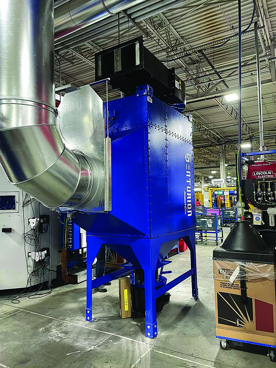

The Senturion dust collector reportedly protects against any type of particulate, including the mix of fine and coarse particulate that turning produces. Image courtesy of RoboVent
A source capture system is most effective at removing dust, fumes and aerosols from the breathing zone. Robotic turning processes should be enclosed or hooded to prevent these particulates from propagating through a facility. For manual turning, fume arms or backdraft or downdraft tables may be used.
Source capture systems should be designed to effectively capture the particulate. Ensuring that designs are close to the particulate generation point while not interfering with employee work areas is critical. Always look at the direction of particulate generation when designing an efficient system.
The source capture system should be connected to a dust collector to filter the air. If oil mists are present, the collector must be fitted with appropriate filtration for mist. If both particulate types are present, multiple filtration stages could be necessary.
