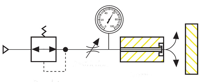

The original air gages, known as flow gages, were based on a still-valid technology that has, nonetheless, been rendered virtually obsolete, replaced by backpressure gaging methods.
“Think of a garden hose that’s spewing water out the end,” said Jack Gaughan, vice president of Edmunds Gages, Farmington, Conn., in explaining air gaging. “If you put your thumb over that hole, the hose grows in size. As you take your thumb away, this releases the pressure and the hose shrinks in size. That’s the basic premise behind air gaging. You can either look at it in terms of backpressure—how much the hose grows when you restrict the water—or in terms of how much is allowed to flow out.”

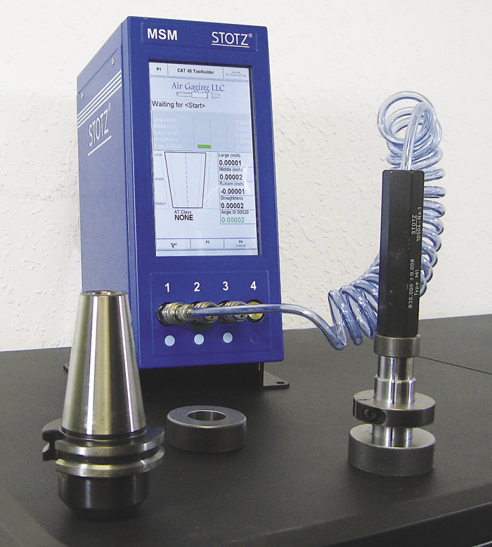

Stotz offers dual-master air gaging systems, which offer the flexibility of certifying across the entire tolerance range. Image courtesy Air Gaging.

Backpressure gaging is roughly split into three categories. Single-master, or differential, systems take air into the amplifier and split it in two directions; one stream goes to the tool, while the other one goes to a fixed orifice in the amplifier. The master, a nominally sized part that fits onto the tool, equalizes the pressure in both legs of the airflow. When the tool is applied to a part for measurement, the calculation is based on the differential between the airflow to the part and the airflow to the fixed orifice.
The advantage of that type of system is that it’s extremely simple to use; however, a dual-master gage is more versatile, because it allows the user to specify the minimum and maximum tolerances, according to Chris Koehn, president of Air Gaging LLC, a Freeport, Ill.-based reseller of Stotz dual-master air gages.
“Other companies have different approaches,” he said, “but Stotz has had the most success with a dual-master system. The advantage is that this system certifies across the entire tolerance range, whereas with single master, you’re not actually certifying at the upper- and lower-tolerance limit, only at the nominal value.”
The third main category of backpressure gage is the two-master variant known as backpressure bleed. It offers even more versatility than single- and other dual-master systems, explained Edmunds’ Gaughan.

Air gaging works by forcing compressed air through a nozzle and measuring either how much air is able to flow out or how much air is kept in the circuit (backpressure). Illustration courtesy Edmunds Gages.
Airing differences
“With both differential and backpressure air gages, the tool has to be made to match an orifice in the amplifier, meaning that if you want to measure to a 0.001″ tolerance, you need an amplifier that can display a 0.001″ spread, and you have to have a tool made for that amplifier,” he said. “If you have another hole with a 0.005” tolerance of the same nominal size specified, you need a completely different amplifier and a completely different tool made for that new
tolerance. With a backpressure bleed system, the air is adjustable and there’s no fixed orifice in the amplifier, so you can adjust a tool that’s made for a 0.005″ range and simply readjust the amplifier to make that same tool display a 0.001″ tolerance.” This means shops need fewer amplifiers and fewer tools, he explained. The “bleed” in the system’s name refers to the excess air that can be bled off to meet different tolerance requirements.

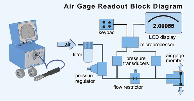

Western Gage's MiliCheck gage (left) utilizes outputs from two transducers—one measuring backpressure from the nozzles, one monitoring regulator pressure—to eliminate errors related to supply pressure variations. Illustration courtesy Western Gage.
Western Gage’s MiliCheck gage (left) utilizes outputs from two transducers—one measuring backpressure from the nozzles, one monitoring regulator pressure—to eliminate errors related to supply pressure variations. Illustration courtesy Western Gage.

In addition, automated air gaging is increasingly popular, according to Sharon Garcia, who is involved in gage sales at Western Gage.
“If you’re running parts in a tightly controlled application, the air gage’s sensitivity to tolerance is going to be helpful from a QC standpoint, and the simplicity lends itself very well to an automated production line,” she said. “The technology itself may not have evolved that much, but the world around it has been developing and integrating this technology in very exciting ways.”
Western Gage’s Moors said many companies blend the best of both worlds by using a digital and analog hybrid readout, which allows novice and expert users to maximize gage data. Douglas’ Loria is one such user who appreciates the inclusion of analog technology.
