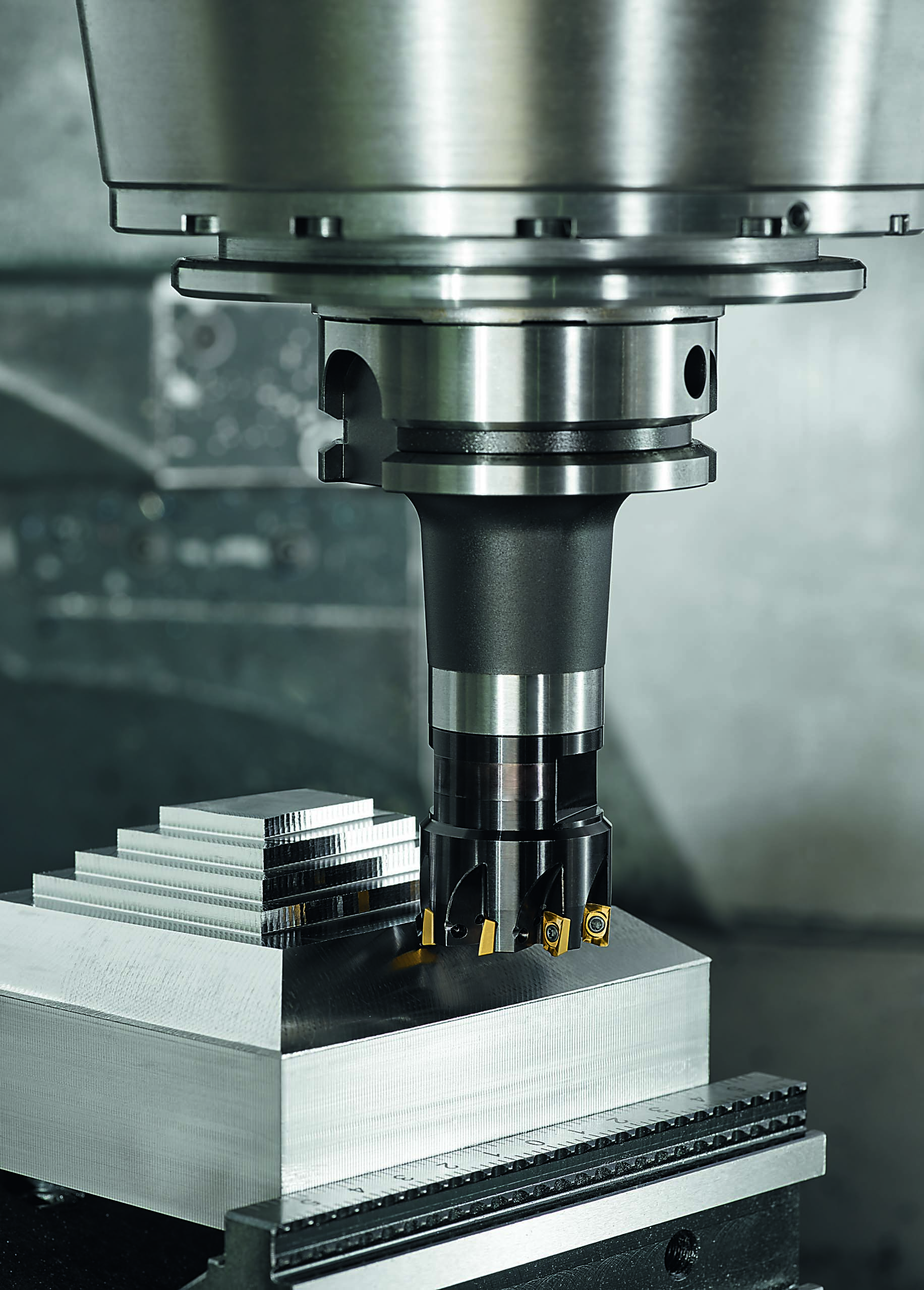

“One of the chief problems with exotic materials involves heat,” Pollock said. “In these cases, the substrate, coating and geometry (have) to be combined in such a way as to maximize heat dissipation. For instance, we have recently introduced what we call Tiger-tec Gold — an ultralow-pressure CVD coating in which we have introduced a larger percentage of aluminum in the TiAlN composition. This enables the insert to handle more heat and results in longer tool life. We’re seeing that premium grades such as this are extremely successful in high-volume applications and are quickly replacing older, more traditional grades.”

All about facemilling
Tiger-tec Gold inserts are displayed in a facemilling application. Image courtesy of Walter USA
