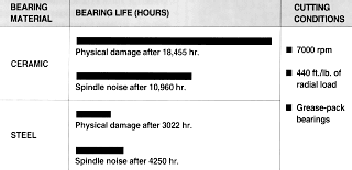

The bearing material is just as important as the bearing type. Although steel bearings are the most widely used in spindles today, there are many advantages to using ceramic bearings for high-speed machining applications. Steel bearings may be less expensive, but they have a greater weight than comparably sized ceramic bearings. Since they have more weight, steel bearings generate more heat, requiring the use of a more elaborate type of spindle cooling system. Also, as the rpm increases, the centrifugal force being applied to steel bearings is higher, increasing growth due to heat. This, in turn, leads to greater horsepower requirements.
Since ceramic bearings are lighter, they suffer less thermal expansion. Tests have shown that ceramic bearings grow at 1/4 the rate of steel bearings. Because ceramic bearings have less centrifugal force being applied to them at high rpm, they can use a higher preload, which improves the spindle stiffness and cutting capabilities.
Anatomy of a High-Performance Machine
Figure 5: Ceramic vs. steel bearing life.
All of these features of ceramic bearings translate into longer bearing life. Figure 5 compares the life of steel and ceramic bearings tested under identical conditions.

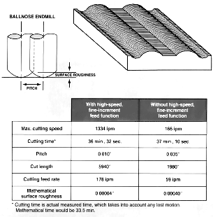

Figure 7: High-speed software helped provide a better surface finish on an aircraft component.
High-speed software allows machining of curved surfaces at up to 1,300 ipm. Three-dimensional parts such as molds and aerospace components can be machined in far less time than previously was possible. This software technology also can be used to improve the surface finish of a part with no increase in cycle time, as shown by the aircraft component test results in Figure 7. The ability to run at higher feed rates and maintain reasonable accuracies allows finer increments to be used in part programs. More passes on a part may be taken to improve the surface finish, without increasing cycle time. This is very important when machining molds or airfoil aerospace parts.
