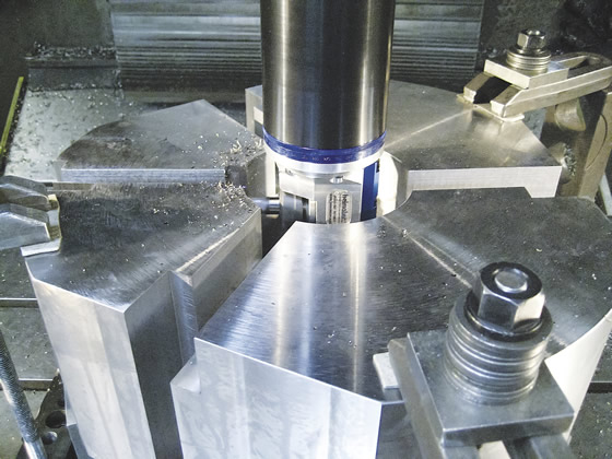

One particularly challenging job requires cutting keyways into a large section on a cutting tool head made of Nitralloy steel. For many years, PMC-Colinet used a shaping machine to produce the keyways in the bores of die heads. Typically, the bores range from 6 ” (152.4mm) to 13 ” (330.2mm) in diameter and more than 12 ” (304.8mm) in length. The keyway tolerances are tight, with location at ±0.0005 ” (0.013mm), width at ±0.001 ” (0.025mm) and depth at ±0.0025 ” (0.064mm).
One style of cut is a three-step keyway that does not run all the way through the bore, stopping instead at a window milled from the part’s OD. This situation posed two options. One required PMC to rough the keyway on the shaper, then outsource the part for finishing with a sinker EDM because PMC doesn’t have that type of machine. This process consumed 50 hours on the shaper, plus about a week for the EDM work.

Heimatec designed this special 16 “-long, 90° angle head for cutting the keyway in a cutting tool head used in the oil field industry.
Milling Foreman Rick Kokish said PMC used both options, depending on which method could get the job done the quickest. “We had one vendor we used who had a large enough EDM to handle our larger heads. We were pretty much at their mercy as to when they could get a head on the machine based on their work load.”
The team at PMC decided to explore methods to increase productivity by producing the part on its Monarch 175B vertical machining center. However, doing so required a 90° angle head to cut a keyway with sharp corners in a bore as small as 6.00 ” in diameter that is parallel to the keyway, so the team conducted an exhaustive Internet search. After more than 30 hours of weeding out unsuitable products, two vendors remained. “First, we eliminated heads by size,” Kokish said. “If the angle head could only do one or two different sizes, it would not be a great fit for us.”

The two angle-head manufacturers visited PMC’s facility and brought their standard designs. One of the qualifiers, Heimatec Inc., Prospect Heights, Ill., quickly realized the job required a custom 90° head design to meet all requirements. For example, none of its standard heads were suitable for producing the keyway in the smallest-diameter cutting tool head, Kokish noted.
Heimatec also gained an edge by presenting a larger, heavier unit for a 50-taper machine, while the competition brought a 40-taper design. “Our die heads are just too large to go on any of our 40-taper machines,” Kokish said. “And the rigidity needed for close tolerances and accuracy would most likely be provided with a 50-taper machine tool.”
Courtesy of Heimatec
PMC-Colinet applies a custom 90° angle head from Heimatec on a Monarch vertical machining center to produce keyways in the bore on an oil field pipe, typically 6 ” to 13 ” in diameter and 12 ” in length.
A week later, Heimatec President Preben Hansen supplied a drawing for the proposed custom product. After reviewing the standard and custom designs from both companies, PMC awarded the project to Heimatec. From conception to installation, the project took about 7 months.
Although the custom angle head for radial drilling and milling is suitable for use in producing various products at PMC, Kokish said the company only uses it for machining keyways in die heads. “We do not want to risk damaging the 90° head with unnecessary abuse on other applications.”
In one angle-head application for a keyway in a bore 6 ” (152.4mm) in diameter and 12 ” (304.8mm) long, PMC spent 6 hours on setup, equally divided between roughing and finishing, and 12 to 16 hours on machining. This saved PMC at least 184 hours on a single part compared to doing the job entirely on the shaping machine.
The design for the custom head includes an adjustable tool stop, three support pins for stabilizing the tool, a 360° indexable pivot on the angle head and an inclined tooth gear to enhance rigidity. Initially, the angle head, which is 3.897 ” (99mm) in diameter and 12.795 ” (325mm) long, appeared too slender to provide the required rigidity throughout the entire cutting cycle, according to Kokish. “It just seemed it would chatter and vibrate,” he said.
However, those fears proved unjustified. PMC only experienced one vibration problem when a support pin became loose. Otherwise, the company deemed the performance successful.
