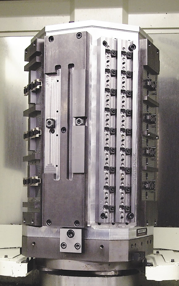

This tombstone fixture includes eight different jobs fixtured with Mitee-Bite clamps.

The result was a fixture that let Hodge Tool machine both sides of 40 work-pieces in a footprint not much larger than a 6″ machinist’s vise. The shop has dozens of similar fixtures, used primarily on a pair of Mori Seiki, 12- pallet-pool horizontal machining cells. “For new fixtures, we design it all in Mastercam and then simulate the whole thing so we can see exactly how it will work,” Clark said. “Then, we take a big steel block and bolt it to a tombstone. From there, we machine out the pockets and mounting holes. Then, we put the clamps on and load up the parts.”
