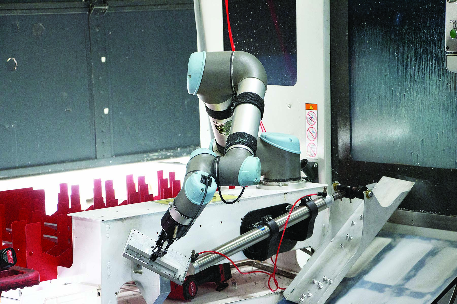

The robot then picks a workpiece, sets it in a re-grip station so the robot can find the part’s center and loads it into the machine. The machine mills the first operation, the robot flips the part to machine the second operation, the part is ejected out of the vise, and a retractor arm pulls the part into a wash bin, ready for subsequent
processes.
The UR cobot’s built-in inputs/outputs allow Go Fast Campers to control all the auxiliary systems through the robot program.
“This has been incredibly useful for us,” said Chief Operating Officer Stephan Morris. “As we actuate the vise, the ejector mechanism, the extractor mechanism, the door cylinder that opens and closes the door — all those things are made
possible by the UR’s easy programming language and the easy opportunity to just plug in different pins to different pneumatic systems.”
For each part machined at Go Fast Campers, a cobot equipped with a force feedback gripper from Robotiq picks an aluminum workpiece from a tray, sets the workpiece in a re-grip station to find the part's center and loads it into the machine.
For each part machined at Go Fast Campers, a cobot equipped with a force feedback gripper from Robotiq picks an aluminum workpiece from a tray, sets the workpiece in a re-grip station to find the part’s center and loads it into the machine. Image courtesy Universal Robots USA
The other key component is the force feedback gripper from Robotiq that seamlessly integrates with cobots. The setup allowed Davis to build a reliable, safe system without having to invest in additional sensors and other systems that workers would have to learn.
“We’re trying to make very good use of the UR ecosystem and all of the other products that come along with that and support both from people and from other companies,” said Ian Sparkman, special projects team engineer. “Being able to add something onto a UR that gives us even more information out of our application has been extremely valuable for us.”
“Traditionally,” Morris said, “in a machine shop you’ll see one operator per machine. With the automation that we’ve been able to achieve with UR robots and our engineering team and Wiley’s initial developments, we’re able to run four machines with one operator over two shifts a day.”
