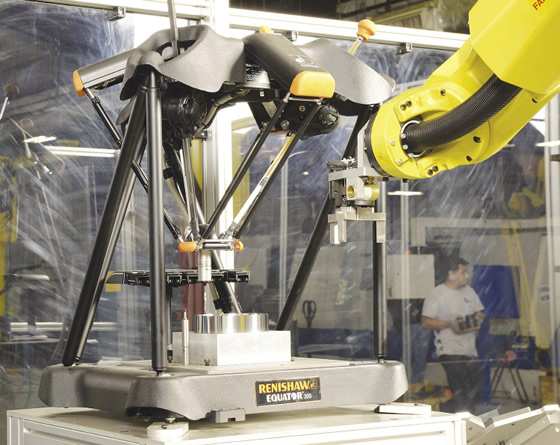

![Conroe_Inspection.tif](/sites/www.ctemag.com/files/article_images/Conroe_Inspection_opt.jpeg)
The Equator gaging system from Renishaw uses touch probing to find the center of a thrust bearing race and then scans the part surface to complete the measurement cycle.

The Equator uses the comparison method of measuring, according to Renishaw. A master part, with known measurements taken on a CMM, is used to “master” the Equator, with all subsequent measurements compared to the master. Repeatability is 0.00007 " (0.002mm) immediately after mastering. “We remaster only once a day, because our shop is climate controlled to 72° F (22.2° C),” Wardell said, noting the process, which includes probe calibration, takes 5 to 10 minutes.
The Equator uses an SP25 probe for touch and scanning data collection at speeds up to 1,000 points per second. Probe styli are stored in an integral six-port changing rack. Although it can be used manually, the Equator’s EZ-IO software enables integration of the measurement system into automated work cells.
In practice, the Okuma lathe’s two part carousels are loaded with about 300 workpieces. The lathe’s dual-gantry loaders feed the spindles and place finished parts on a chute leading to a conveyor for robotic pickup. The robot places the part on the Equator for measurement and, if acceptable, transfers it to the engraving machine and boxes the finished part.
