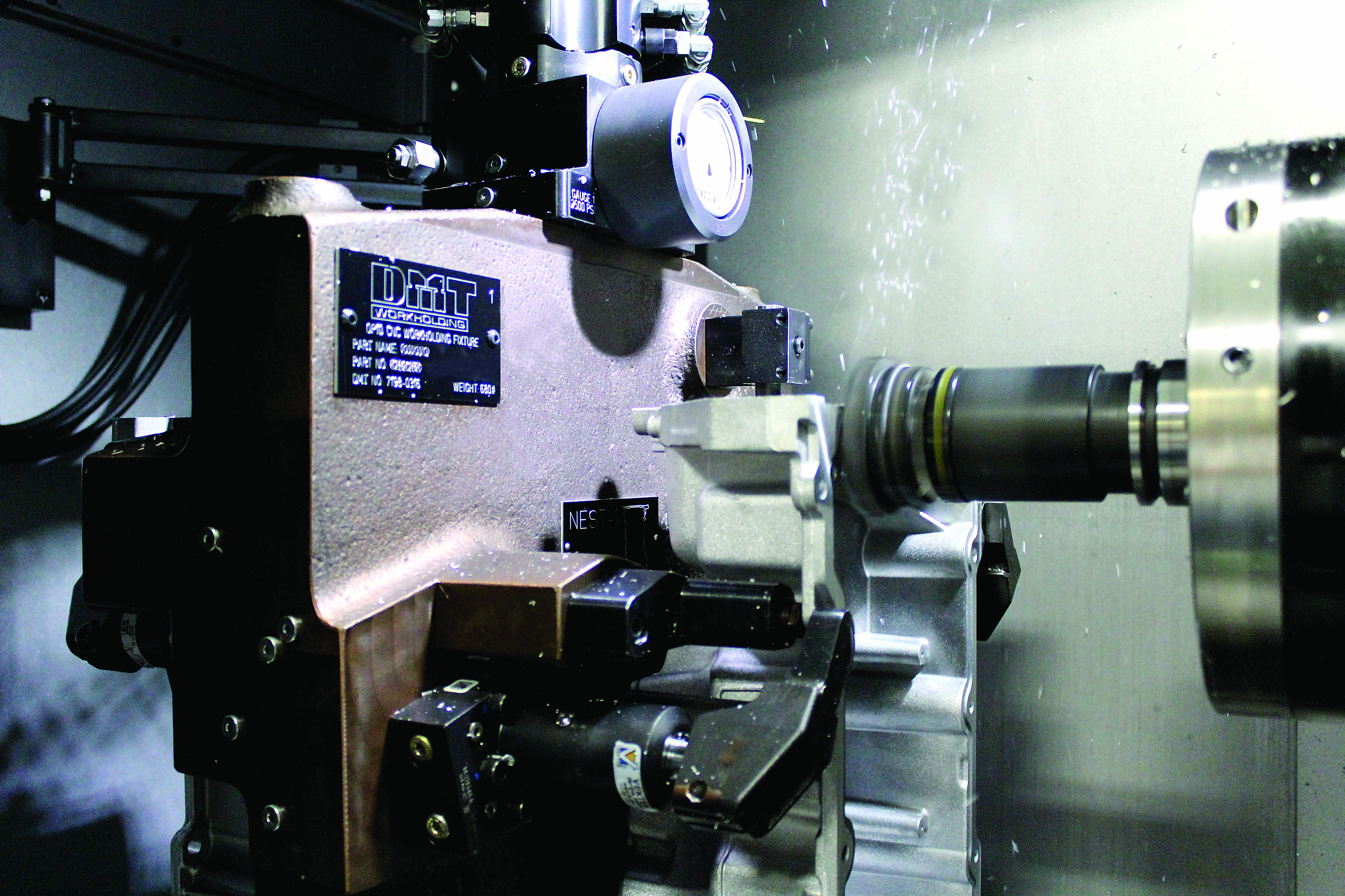

Properly designed hydraulic workholding is a game changer in terms of productivity and part quality. Photo credit: DMT Workholding
Properly designed hydraulic workholding is often a game changer in terms
of productivity and part quality. Image courtesy of DMT Workholding

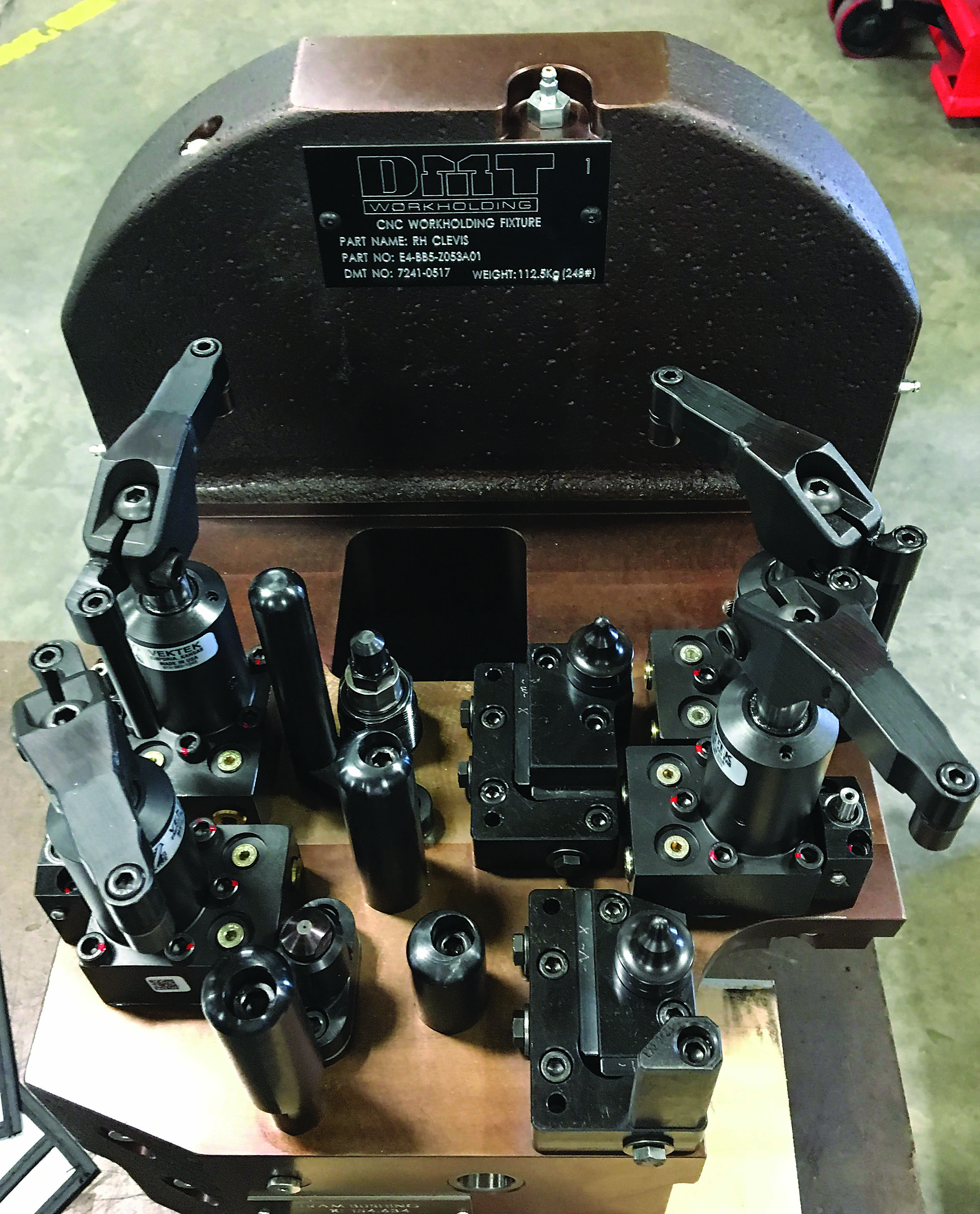

Internal costs and accountability must also be considered. According to Scott Bower, DMT’s executive vice president of sales and engineering, a toolroom might send fixtures to the production floor that aren’t quite ready for prime time. Rework and downtime will result.
Even when an in-house fixture does not work adequately on its first iteration, lost production and rework costs in the toolroom are rarely accounted for accurately. Other costs that are not accounted for come from inaccuracy and the inability to push feeds and speeds as hard as would otherwise be possible due to insufficient clamping pressures or poor datum structures.
“Using the correct workpiece datums is key to effective workholding,” Bower said, adding that DMT is working on a job in which the company that designed and built the original fixture made design choices that led to the use of undersized componentry, either from a cost-saving perspective or from inexperience. “They ended up in a situation where it was impossible to achieve the forces needed to truly hold the part in place.”
There isn’t the same level of accountability as when you work with an external workholding supplier, Bower explained. If it’s not done correctly the first time, it’s no big deal to send it back to the toolroom for adjustments. The actual tooling costs are also frequently skewed in the toolroom’s favor. Maybe the burden rates aren’t applied properly, or the rework and reduced productivity aren’t taken into consideration during the costing process. “You don’t have any of that when you work with a qualified supplier,” he said.
