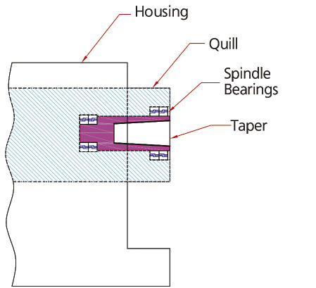

Dead tailstocks consist of a housing and quill with a mounting taper (Figure 1). The taper is commonly a Morse taper, but Jarno and Brown & Sharpe tapers are found on some machines. Live tailstocks add a rotating spindle with bearings to the assembly (Figure 2). Lathes with dead tailstocks require a live center while live tailstocks require a dead center. Because grinders rotate at lower speeds, they may employ live or dead centers in either style of tailstock.

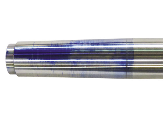

Properly done, bluing the ID with a taper gage will highlight out-of-roundness or other visible damage to the taper (Figure 3). The bluing should be at least 90 percent visible on all surfaces. Any large gaps or heavy bluing are sure signs of a deformed taper.

Figure 3. Bluing on a taper gage should be light and even (above). Heavy bluing indicates the taper did not contact the quill interior, while gaps mean the fit was too tight (below).

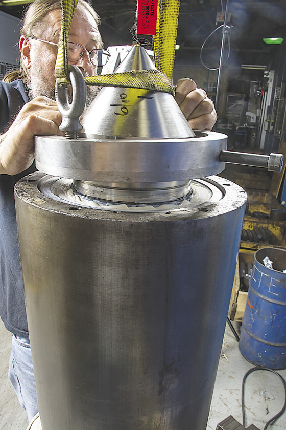

Figure 5. The new spindle is lowered into the repaired quill, achieving a slip fit.

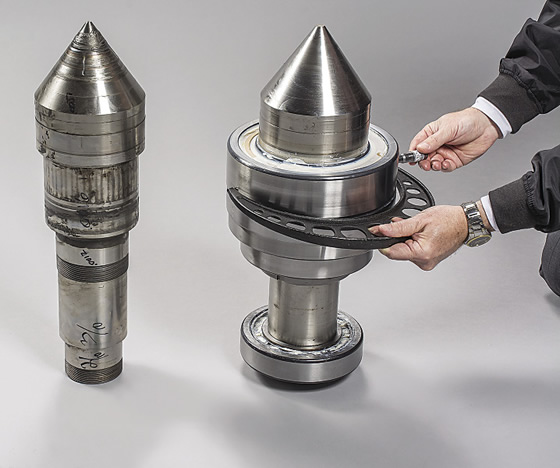

Surprisingly, the taper, in this case a 60° point, had only minor wear, but the spindle bearings were irreparably damaged (Figure 4a). There was also noticeable wear to the bearing seats on the quill ID, indicating the bearings were not seating properly. There was also obvious wear on the spindle bearing journals. Running the lathe to the point of catastrophic bearing failure damaged both the quill and the spindle.
The most economical solution was to remanufacture the spindle bearing journals and lightly grind the taper to remove wear and restore concentricity to the new bearing surfaces. Magnetic particle inspection of the rebuilt spindle was performed to ensure its structural integrity. New bearings were installed, making sure they were matched for size and correctly mounted (Figure 4b).

The final step in the process was inserting the new spindle and bearing assembly into the quill. On smaller quills, a simple press fit is usually sufficient. However, in this instance, the housing was more than 5 ‘ long, so a more complex slip-fit procedure was required. The spindle was encased in dry ice while a heater was inserted into the quill. During this process, the spindle shrinks and the housing expands. The spindle was then lowered into the quill (Figure 5), and when both were returned to ambient temperature, a precise fit was accomplished. The completed tailstock was then tested to ensure the bearings were functioning properly.
