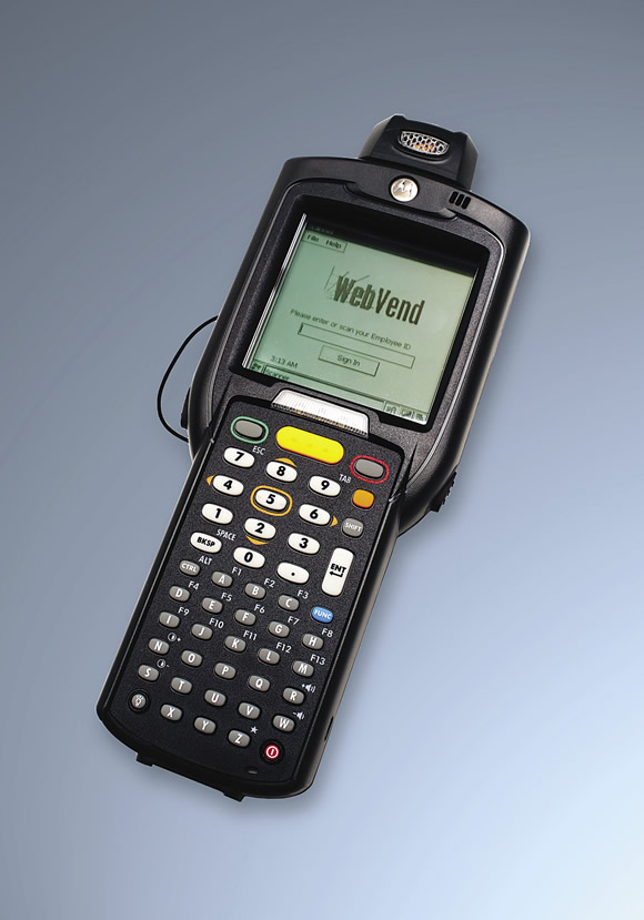

Bar code scanners can help reduce administrative costs by automating the tool acquisition process. In this type of system, the empty box is scanned to create a purchase order and the new box is scanned to receive the inventory, eliminating paperwork.

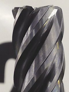

Conservation of the cutting edge is the cornerstone of a successful management program. Notice the chipped edges on this abused tool. This tool will require significant reconditioning and, in some shops, cannot be used again.
Therefore, conservation of the cutting edge is the cornerstone of an effective tool management program, because tool life is the most significant factor in tool cost. It is common practice to machine as fast as possible, but speed does not always improve cost. Going as fast as possible can cause premature tool wear and damage. Extending tool life without compromising efficiency is a delicate balancing act. Maximizing tool life also minimizes tool changes and, therefore, the opportunity for mistakes at the control.

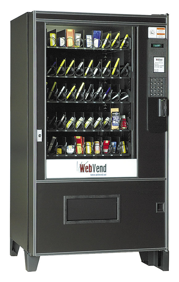

Vending machines are not just for the breakroom. They can be placed in the work area to allow immediate, controlled access to tools. Some machines are networked to the vendor and allow real-time inventory management.
