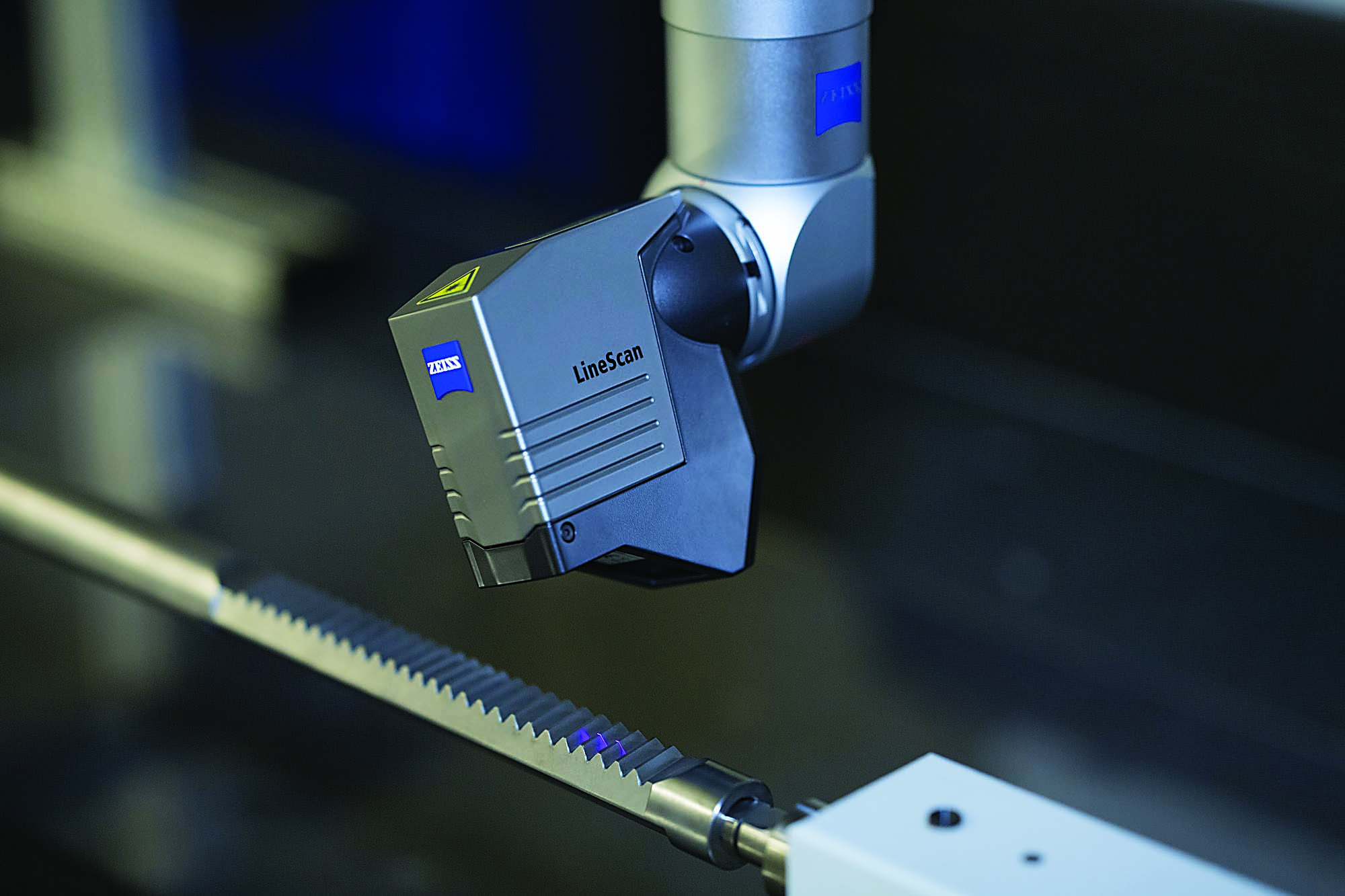

Multisensor CMMs provide less obvious benefits as well. By equipping one with a laser line scanner, for instance, a user could generate a 3D model of the cylinder head just described and then use it to develop an inspection routine or even reverse-engineer the part.

Many multisensor measuring systems provide laser line scanning capabilities, a noncontact way to quickly and accurately capture 3D surfaces. Image courtesy of Carl Zeiss Industrial Metrology

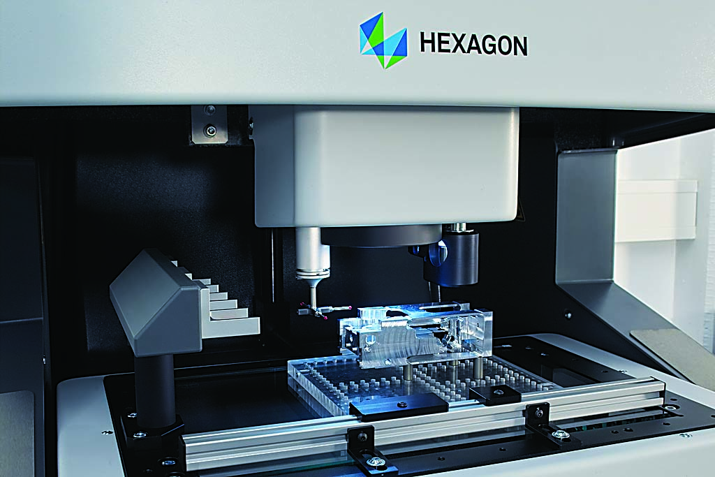

Tobias M. Weber agreed. He is product manager of the Optiv line of multisensor metrology equipment at Hexagon’s Manufacturing Intelligence division, North Kingstown, Rhode Island, He said a few days of intensive training is required to use the company’s metrology hardware and software to their fullest potential, especially for creating optimized part programs. But for more basic tasks, a highly intuitive interface minimizes the need for training.
“One of the main strengths of our multisensor CMM solutions is their flexibility along the entire metrology workflow of our customers, making them a kind of metrological Swiss knife,” he said. “On the other hand, we tend to focus more and more on delivering complete solutions for specific applications in the electronics, medical, aero-engine or automotive segments. These include semiconductors, stamped and bent metal parts, turbine blades and small gears — generally, any sort of high-precision small part is especially suitable for measurement on this type of equipment.”
The Optiv M 3.2.2 benchtop multisensor CMM provides part manufacturers with a range of preconfigured EPS packages optimized for individual applications and production targets. Image courtesy of Hexagon’s Manufacturing Intelligence division
Like multifunctional CNC machine tools, multisensor metrology equipment is not inexpensive. Yet it’s important to look at the big picture.
“It is usually less expensive to purchase a combination of features within a single system than investing in the equivalent individual pieces of equipment,” Weber said. “Further, part handling is much more efficient when a single system is used to complete all measurements, especially when palletized measuring or automated loading is involved.”
