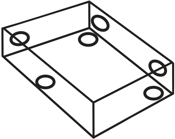

A nonround part usually has six datum points.
Round parts can be turned and cut with stationary tools. Nonround parts must be held stationary and cut with rotating tools. Effective workholding allows shops to machine both types of parts fast and accurately.
Workholding requires datums, or dimensional origins, for each part. Datum targets vary with each part, but a minimum of six points are required to define an adequate workholding system for any part. There are typically three points on the OD of a round part, and three points on the face of the part. Round parts may also require an orientation about the centerline of the axis.
There are typically six datum points on a nonround part: three on the bottom face, two on the top edge and one on the side locator (see figure above). Traditionally, it has been the responsibility of the customer, or end user, to define the required work material and type of manufacturing process and provide the datum points on the part prints. Today, it is becoming more common for the end user to pass these responsibilities to the value-added supplier, the shop making the part. As a result, the shop must fully understand these requirements and how they affect workholding.
