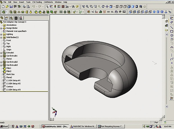

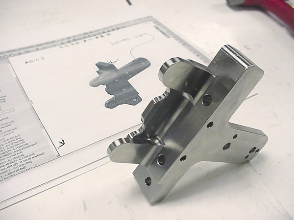

Parts are often easier to model than they are to machine. All images courtesy J. Harvey.

It’s important to initiate a new project with proper planning. It is one thing to create a beautiful model or drawing on a computer. It is quite another to figure out how to hold the part for machining.

Planning involves a variety of decisions before any material is cut. The list of questions to answer includes:
- How is the part going to be held? Will a fixture be needed?
- What sequence of setups will be used?
- What size raw stock are you going to start with?
- What size cutters will you choose and are they available?
- Will squaring be done beforehand or in the part program?
- Is the part rigid or will flimsiness be an issue?
- What speeds, feeds and DOC will you choose?
- Where are the G54 starting points going to be placed?
- Will the part have to be roughed first before finishing to avoid warpage?
