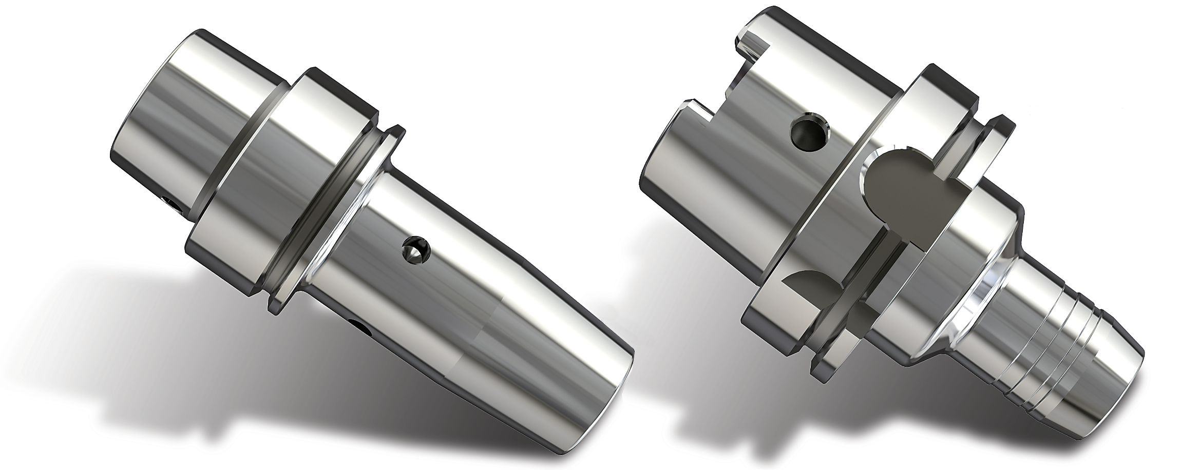

YG-1 Tool (USA) offers a wide variety of toolholders, including hydraulic chuck (right) and shrink fit left). Images courtesy of YG Tool USA

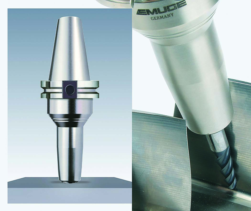

Emuge-Franken USA took a different approach to enhancing that tried-and-true technology, said Milling Products Manager Dan Doiron. In addition to a wide range of high-performance cutting tools, the West Boylston, Massachusetts-based toolmaker sells Franken Precision Chuck holders, which are manufactured by partner company Albrecht.
He explained that unlike an ER collet with its relatively steep angle of about 30 degrees, an FPC holder has a shallow taper of about 1.5 degrees to provide a consistent gripping force along the entire tool shank.
“The taper is what’s aligning a tool into its sweet spot of concentricity,” Doiron said, “and it’s pulling it from the stem versus when you’re going into the ER collet. It’s being compressed from the top with a nut.”
He added: “It looks like a hydraulic holder, but it’s not. It’s mechanical. It has a collet.”
Doiron said having a collet means that an end user isn’t restricted to one tool diameter per holder while the holder’s metal-on-metal compression effectively grips the tool in the collet.
In one application where a customer experienced chatter issues, he said he recommended changing only the holder while running the same cutting tool at the same machining parameters. As a result, the tool produced 350 parts after the switch compared with 65 to 75 parts previously.

Emuge-Franken offers a slim-line version of the FPC chuck. Image courtesy of Emuge-Franken

When an application requires a holder and tool assembly with the least amount of TIR, especially when running at a high spindle speed, Raun recommends shrink-fit toolholders.
“They’re balanced for that purpose,” he said. “If you can move to shrink, that’s always the best-case scenario.”
However, some shops hesitate to make that move from fear of workers potentially burning their hands because a shrink-fit holder must be heated to expand the bore so it can accept a tool shank, which then is held rigidly after the holder is cooled rapidly.
“Sometimes there’s a safety factor that companies don’t like,” Raun said.
In addition, manufacturers must purchase a shrink-fit holder machine, which has an electric induction heating coil.
When a manufacturer decides against a shrink-fit system, Raun said a hydraulic holder provides a sufficiently high level of accuracy and clamping force but only for finishing applications, as well as axial-type applications like drilling or reaming.
“You’re not going to really be able to put a lot of side load or do a lot of heavy roughing with that type of toolholder,” he said. “It has a tendency to flex internally because it has a bladder around the tool as far as how ‘hydro’ tools are designed.”
Pulvermacher agreed that hydraulic chucks for drilling give performance benefits. He said an advantage for a hydraulic holder is that it can accept a reduction sleeve to hold a tool with a diameter that’s slightly smaller than the holder’s bore.
In addition, he said the reduction sleeve, which is like a taperless spring steel collet produced to a high-quality standard, provides a damping effect while still maintaining minimal runout.
