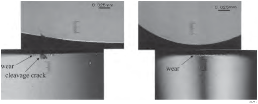

A comparison of the cutting edges of a monocrystalline diamond tool (left) and a nano-polycrystalline diamond tool after machining tungsten carbide on a CNC lathe using elliptical vibration cutting.

To overcome these obstacles, Sumitomo Electric Industries Ltd., which has head offices in Tokyo and Osaka, Japan, developed SumiDIA Binderless nano-polycrystalline diamond. Sumitomo Electric offers ballnose endmills and turning inserts tipped with the material, while Tokyo-based A.L.M.T. Corp., a Sumitomo Electric company, offers BL-UPC series tools, including aspherical surfacing tools, grooving tools and ball endmills.
The diamond material has a single-phase body synthesized by firmly and directly bonding diamond grains that are several tens of nanometers in diameter, the company reports. Sumitomo Electric produces the material under higher temperature and pressure conditions than when creating synthetic, single-crystal diamonds. The binderless, single-phase, nano-PCD material reportedly does not cleave and is harder than conventional PCD and single-crystal diamond material.
When applied on a CNC lathe using elliptical vibration machining, where a cutting tool is attached to a cylindrical support body vibrated by at least two piezoelectric drive elements, a BL-UPC tool with a -20° rake angle imparted a 7.4nm Ra surface finish, according to the company. The DOC was 2µm and the feed was 5 µm/rev. The workpiece was tungsten carbide containing 12 percent cobalt.
In addition to cemented carbide, suitable workpieces include hardened steel, glass and silicon carbide.
