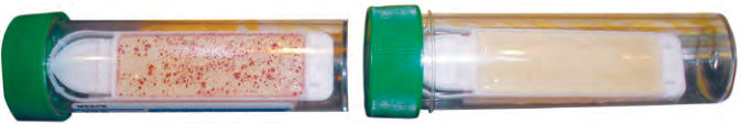

The Guardian coolant recycling system from PRAB/Monlan uses a continuous overflow process to prevent rancidity. Bottom: On the left, a bacteria test strip dipped into coolant immediately before starting the Guardian’s coolant manager indicates bacteria growth. On the right, a bacteria test strip dipped into the coolant 6 hours after the coolant manager has been injecting ozone into the coolant shows an absence of bacteria.

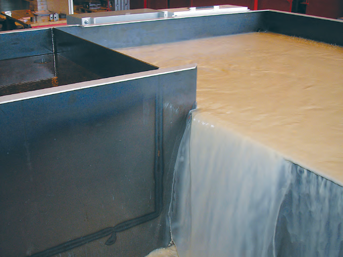

A continuous overflow process using two 800-gal. tanks prevents rancidity by ensuring clean fluid spills into the dirty tank. That eliminates bacteria from forming in the clean tank due to pooling. In addition, the continuous overflow process cleans the coolant as it repeatedly passes through the liquid/solid filter and the coalescing filter for liquid/liquid separation.
Bacteria growth is retarded through injection of ozone into the coolant via an automated coolant manager. Graf, who assisted with the installation, tested the system to ensure it was inhibiting bacteria growth. “In just 6 hours after the coolant manager had been injecting ozone into the coolant, it was completely free of any bacteria growth,” he said.
