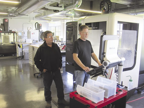

Derek Goodwin, president of manufacturing consultancy Goodwin Manufacturing Group, Morgan Hill, Calif., is out to change this conundrum. The group offers packages of CAM-centric services that bridge the gap between the acquisition of advanced manufacturing systems and fully using their capabilities to boost productivity and reduce costs.
Derek Goodwin (left), president of Goodwin Manufacturing Group, works with Lime Lab Inc. Prototyping Manager Chris Iverson to get a DMG Mori DMU50 5-axis vertical machining center operating near its full potential within weeks of installation.
Goodwin’s team starts by evaluating the business objectives that drive the acquisition of a new technology and how this technology can be integrated with the company’s existing CAM processes.
“CAM is central to managing everything that happens on the shop floor,” he said. “It is the place where we can review our process from beginning to end and get everything right before we start making chips.”

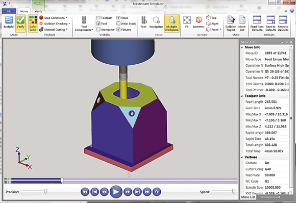

With Mastercam for SolidWorks, prototypers can do all of their work, including writing and simulating CNC toolpaths, within the SolidWorks programming environment.
With this process, Goodwin said his company can implement technology acquisitions and process improvements in weeks that would take a customer’s internal teams months to complete. One element that moves the process along quickly is knowing the CAM software’s strengths and how they might be applied to bridge gaps that prevent advanced manufacturing systems from operating efficiently.

In one project involving manufacturing a family of parts on a 5-axis machine, Goodwin’s team reduced the machining cycle from almost 4 hours to 20 minutes. He noted the bulk of this reduction was achieved using Mastercam’s Dynamic Motion technology, which automatically adjusts feeds, speeds and cutting tool entries based on the real-time condition of material ahead of the tool. This avoids burying the tool, allowing a manufacturer to confidently run at the highest feasible mrr and reduce tool wear.
In addition, Goodwin attributed about 20 percent of the cycle-time reduction to developing a custom post-processor to resolve short-distance servo acceleration and deceleration issues that prevented the machine from achieving its inherent high-speed machining capabilities.

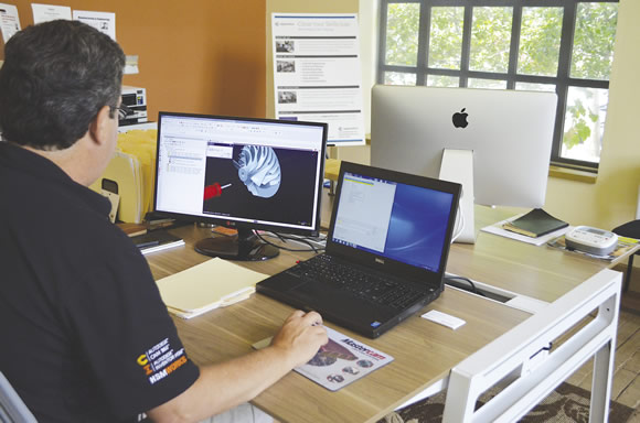

Even when most of these issues have been meticulously addressed, there can be surprises. As a result, new 5-axis posts must be rigorously proven before they become part of a manufacturing process. The most demanding test involves making a complex part that requires simultaneous 5-axis machining.
For one contract manufacturer, the group implemented a 5-axis process on the rotary table of a twin-table horizontal mill. “It was a brand new machine and they did enough 5-axis work to know that the process must be thoroughly proven before it could be offered to customers without the risk of violating their lead-time expectations,” Goodwin said. “We decided the best test for this post would be manufacturing a blisk. Programming a blisk can be very complicated and this company had not yet written the program. We bridged this gap by installing Mastercam’s Blade Expert software, which creates complete blisk programs simply by having the programmer enter data in a pop-up table in the software.”
The project was completed in a few weeks. The manufacturer not only wound up with a proven 5-axis machining system and post-processor, but also a process for generating programs for blisks and blades.

Derek Goodwin uses Mastercam Blade Expert software to develop a test program to prove out the post-processor for a customer’s new 5-axis machining center.
