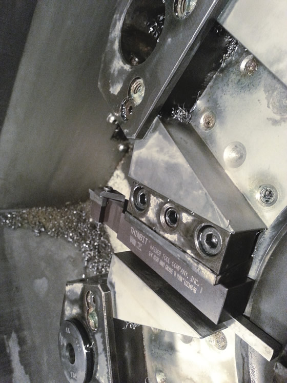

Thinbit Groove ‘N Turn tools are ground with a clearance, enabling plunging and turning at diameter to produce the required width.

Alecto Industries can apply one Thinbit Groove ‘N Turn tool to produce grooves with different widths.
“When Alecto President Jim Szwaya asked me if we could run these parts, I instantly thought of Thinbit,” Musial said, referring to Thinbit grooving and turning tools from Kaiser Tool Co. Inc., Fort Wayne, Ind.
He added that one Thinbit tool can be applied to produce grooves with different widths, which reduces cycle times and provides savings that can be passed along to the customer.
He noted the shop primarily uses Thinbit Groove ‘N Turn tools, which are ground with a clearance, enabling the shop to plunge and turn at diameter to produce the required width. “Depending on the job, we also turn to rough a groove, then take a finish pass to depth, adding chamfers on the sides,” Musial said. “The versatility makes my job easier. We are always searching for ways not to pick up more tools or do any more operations or part handling than we have to.”
In addition to insert design, insert durability increases throughput by enabling high-speed grooving, according to Musial. Although Kaiser technical support recommends to “run it until you break it,” he noted going a bit slower enhances insert life while still boosting productivity by reducing the downtime required for tool changes.
