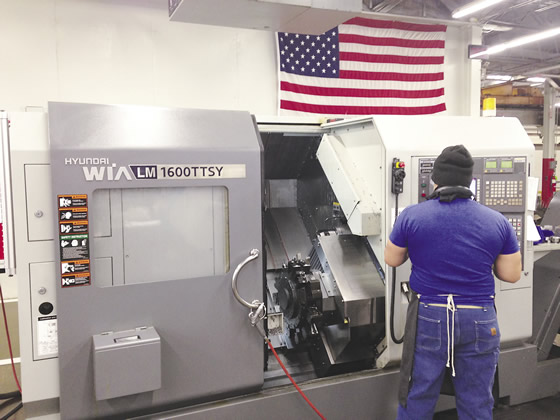

Pat%20at%20lathe.tif
A machinist prepares a lathe for a process capability study.
