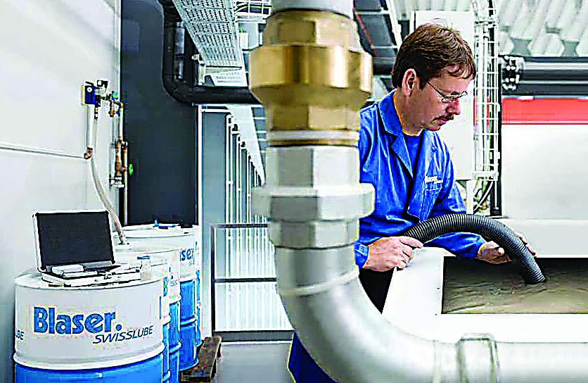

While coolant foam won’t invade workers’ nostrils with the scent of rotten eggs or inflame their skin, it can cause a host of other unwelcome consequences. Those include reducing a fluid’s lubricity characteristics, obstructing proper skimming of tramp oil and interfering with a shop’s ability to manage chips by preventing them from settling on the bottom of a sump and carrying the chips to where the filtered coolant is located. “Then you’re pumping chips through your system and plugging the coolant nozzles and causing downtime to clean the system,” Templin said.
He added that foam creates an insulating layer or air on top of the coolant, causing it to heat up. In addition, high-pressure pumps generate a significant amount of heat in a fluid system. A high-temperature fluid doesn’t effectively cool the tool/workpiece interface, and coolant that’s around 100° F can cause dimensional changes to the workpiece material and machine, noted Ed H. Rolfert, project engineer for Cimcool Fluid Technology’s R&D laboratory, Cincinnati. “Then you have part-quality issues.”
Courtesy of Blaser Swisslube
Coolant should have excellent antifoam properties for high-pressure applications, such as this milling operation.
