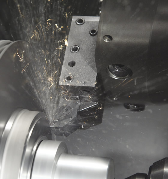

If this is the best thing since sliced bread, why aren't machine tool builders equipping their CNC lathes with quick-change-capable turrets? That would certainly go a long way toward reducing the high investment cost. Fischer explained that some builders have tried this, but met with poor results.
"If you buy a machine with a turret dedicated to one brand of quick-change tooling, you're really locked in," he said. "And there are very few situations where every tool you're going to use has a quick-change adapter. So if my turret is dedicated to KM or Capto [quick-change tooling], that's great, so long as every tool I'm going to use—ever—is available in that platform.
"Most shops are not going to be all Kennametal [KM] or all Sandvik [Capto]," he continued. "And it's very unlikely you're going to find one system that meets every need. Boring bars, especially, are a problem, because you're locked into whatever length is available for the toolholder. There are times when you might have chatter issues and you'll need to adjust bar length to maximize your reach and minimize your chatter. If you're tied into one system, maybe you can't do that."
Fischer pointed out another flaw of dedicated quick-change turrets: stuff happens. "With our turrets, you have to mount a quick-change tool block of some sort. This makes it easy to mix and match different tooling systems. But the nice thing is, if you have a crash, you can replace the block and you're back in business. It's not like you have to rebuild the turret. This not only gives you a lot more flexibility, but less risk of extended downtime for machine repair."

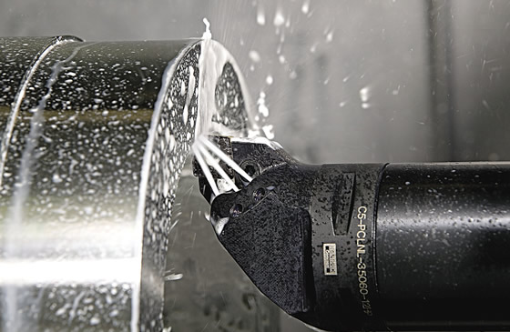

Integrated cooling allows for efficient chip evacuation during a boring operation using a quick-change head.
From a quick-change perspective, this means whatever the machine tool brand, chances are good that a quick-change tool block exists that bolts directly to the machine's turret. These blocks have the proper bolt pattern, clearance and coolant inlets.

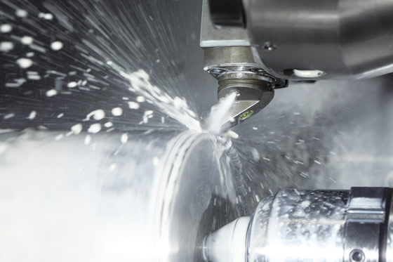

A KM quick-change tool turns a steel part with coolant. View a video comparing the KM quick-change tool to a standard tool by clicking this link.

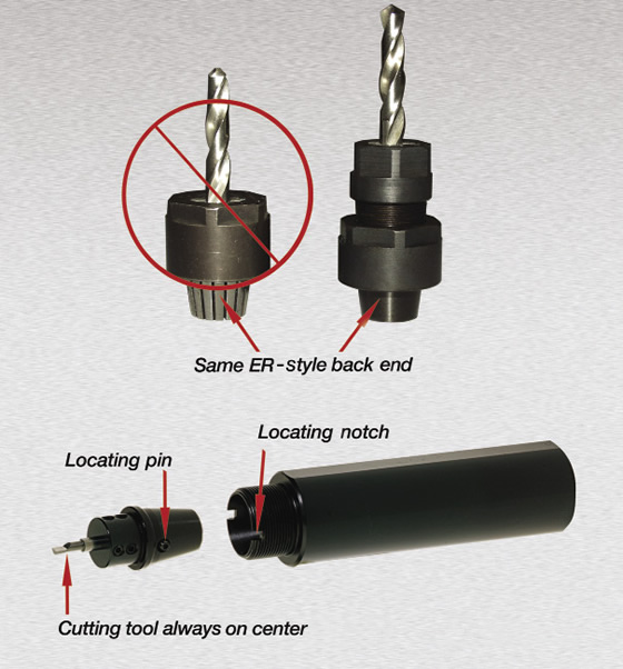

It's a common assumption that quick-change tooling is expensive, but it doesn't have to be. A low-cost quick-change alternative comes from American QC Systems Inc., an offshoot of a Bradenton, Fla., machine shop. Owner Dan Walters said, "We have a design that fits into any ER-style holder and is used for quick-change of round-shank tools. It's a fraction of the cost of competing systems."
Walters sees quick-change a little differently. "To me, it's all about a shortage of machinists," he said. "We've used these holders in our sister shop, American Torch Tip Co., for more than 5 years. As a result, we've eliminated the need for skilled machinists to change tools. It's a big cost savings for us. We can hire people with no machining skills, bring them in and have them be effective immediately. All they have to do is be able to unscrew the nut and pop in a new tool."
American_press%20re.%20pict.tif
Courtesy of American QC Systems
American QC Systems makes quick-change toolholders for ID tools.
With 5,000 part numbers in its catalog, American Torch Tip performs more than 20 setups a day across 40 machines. "We keep maybe 100 tools set up all the time," Walters said. "These are the standard tools we use most frequently, and they're preset the same no matter which machine you put them on. For everything else, we have the tools kitted in bins. All the operator has to do is read the setup sheet, load the tools, enter the offsets and hit go."
Because of this, American Torch Tip enjoys setups that take minutes, using operators whose only previous skills might have been flipping burgers. "Buy a new machine and you've just created a problem for yourself," Walters said, "because you'll be unable to find a machinist to run it." Walters has solved this with quick-change tooling. "We invested big into it to start, but over the years, the cost per year has dropped to nothing, and I can hire anyone."
