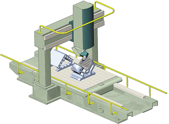

As implemented in Mastercam X7, machine simulation allows multiaxis equipment to operate safely when unattended.
