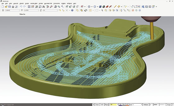

Wolfert Tool & Machine Co. Inc., St. James, Mo., says it employs the same Mastercam Dynamic Motion technology it uses to make thin-walled parts for aerospace customers as it does to manufacture single-billet aluminum Metalin guitar bodies, which are light, strong and have excellent tone quality. Images courtesy CNC Software.

Ben Mund, senior marketer at CNC Software Inc., Tolland, Conn., said the company’s latest release, Mastercam X8, includes a revamp of its 5-year-old Dynamic Motion technology. “Rather than offsetting the part geometry a set amount, Dynamic toolpaths are based on the material-removal rate. They essentially ignore the shape of the part in favor of consistent tool load.”
Dynamic Motion produces toolpaths that some machinists might shake their heads at, Mund said. “A traditional toolpath looks logical. It uses regular step-over amounts that, as a rule, follow the part shape. Dynamic toolpaths, on the other hand, appear chaotic. The cutter shifts to maintain constant engagement without regard to part geometry.”

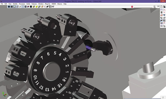

GibbsCAM toolpath simulation shows two tools cutting simultaneously on a Tsugami TMU1 Swiss-style machine. Image courtesy Gibbs and Associates.

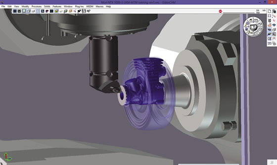

Facing an offset casting on a DMG Mori NTX 1000 as displayed on GibbsCAM’s Universal Kinetic Machine. Image courtesy Gibbs and Associates.
According to Gibbs, UKM simplifies modeling and programming of complex machines, makes post-processing faster and makes it easier and simpler to create more accurate toolpath simulations. The software uses an internal programming structure the company calls “a kinematic tree.” This allows users to define multiaxis, multispindle machine configurations where “you can move the part, move the tool, move the spindle—it doesn ‘t matter because all the basics are handled,” he said. “UKM accommodates these wild and crazy machines, yet toolpath creation remains a simple task.”

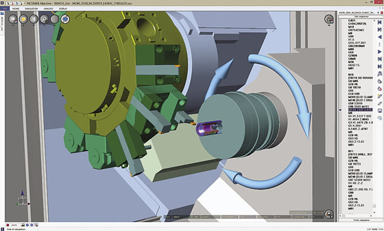

Silvère Proisy agreed. As general manager of SPRING Technologies Inc., Boston, Proisy spends his days spreading the good word of machine simulation. He explained the primary difference between the company’s NCSIMUL Machine and CAM-based simulation is that dedicated simulation products actually read the G code rather than relying on the output of the CAM system’s post-processor to get it right. This generates a more accurate simulation, he said, something that’s especially important with mill/turn and other complex machines.
Simulation packages do more than check for tool interference and potential crashes. According to Proisy, NCSIMUL Machine optimizes the G code, reducing cycle times up to 20 percent. “Optimization looks at several factors, including feeds and speeds, chip thickness, depth of cut and so on. Based on this, the feed rate can be automatically regulated, becoming more aggressive where possible and backing off when necessary. It’s also important to look for areas of wasted cutting motion and convert those into rapid movements.”

G-code simulation is more important as machine complexity grows. Here, a subspindle turning operation is simulated on a DMG Mori NL2500SY mill/turn center using NCSIMUL Machine software from SPRING Technologies. Image courtesy SPRING Technologies.
