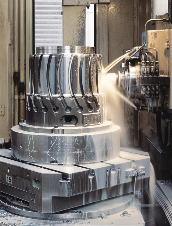

Castle Precision Engineering machines a fan disc for a customer.
