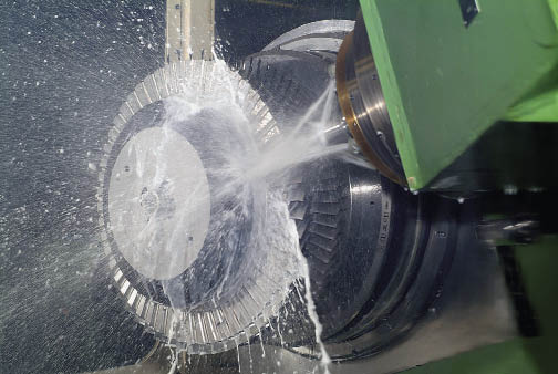

Courtesy of Rego-Fix
Coolants have ingredients for machining, rust prevention, bacteria control, pH stability and other functions. When a coolant is in use, these ingredients are consumed at different rates, depending on the metals being machined and type of machining.
Coolant development has been spurred by several factors, including the rising cost of additives, chlorinated paraffin and oil, and the need to keep pace with changes in the machine tool industry. As new coolant technology is developed, coolant prices typically increase, reflecting the performance improvements and the cost of raw materials.
Coolants now sell for $15 to $28 per gal. or more, so a new look at coolant management and recycling to maximize return on investment (ROI) is warranted.
The term “coolant management” is commonly used to describe the actions and equipment required to maintain coolants at their maximum performance level. The first step in implementing a coolant management program typically involves calling manufacturers of coolant recycling, filtration and oil skimming equipment. These companies will survey your plant and estimate the equipment needed. Savings will be itemized in many categories, including gal. of coolant purchased and reduced waste disposal and machine downtime. They usually provide a projected ROI as well.
At this point, many manufacturers are in a rush to get started. Not so fast! In reality, many of these equipment installations will not generate the promised ROI. Visits to many shops show large numbers of centrifuges, coalescers and filters sitting unused. Why? Largely because the steps to control coolant on a day-to-day basis were not incorporated with the purchase of equipment.

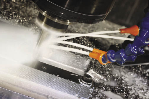

Courtesy of Haas Automation
Coolant development has been spurred by several factors, including the rising cost of additives, chlorinated paraffin and oil.
Coolant Selection
Lower-priced coolants typically do not contain biocides at high enough levels to control bacteria. They contain six to 10 ingredients, use low-cost emulsifiers and little pH buffering. More advanced, pricier coolants provide increased performance by combining 16 to 20 ingredients at optimal levels.
Why spend the money for advanced technology? Coolants are never the same once put to use. You can add coolant to the sump but the resulting coolant will always be a different mix of chemistries than the virgin coolant. The reason is selective depletion. Coolants have ingredients for machining, rust prevention, bacteria control, pH stability and other functions. When a coolant is in use, these ingredients are consumed at different rates, depending on the metals being machined and type of machining.
The most obvious example of this is when odor from bacteria is present even though the coolant is at the proper concentration. This is because the biocide has been selectively depleted faster than the other components. With a central control system, selective depletion many times requires adding ingredients, such as pH buffers and biocides, in addition to replenishing the coolant.
