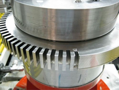

Recently, to demonstrate the capability of Norton’s Vitrium³® wheel with TG2 ceramic grain they conducted two different tests on Inconel 718. In the first test they ground a slot ½” wide by ¾” deep in a 2″ thick part in just 22 seconds. To do this they took multiple passes at 0.10″ depth and a feed of 180″ per minute for a removal rate of 9 in³/min. In a second test they removed 7.4 in³ from the face of a disk in just 2.2 minutes for a removal rate of 3.9 in³/min. It is important to note that neither of these tests caused metallurgical damage or burn, indicating the benefits of cooler cutting and low specific grinding energies associated with Vitrium wheel technology.

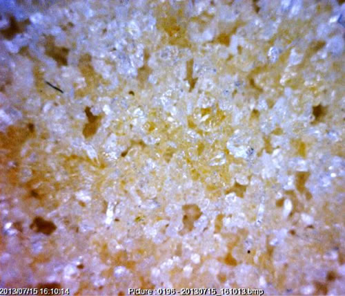

A variety of factors in the past, have prevented grinding processes from reaching high stock removal rates, weak grains that dull and fracture prematurely, weak bonds that take up a large portion of the wheel volume and release the grains prematurely and most importantly insufficient space in the wheel face to accommodate the large volume of material necessary to reach high removal rates. In wheels with insufficient space, chips get crowded in the wheel pores and end up rubbing on the part surface thereby increasing heat in the grind zone and they also increase the force on the grains. This can cause either burn damage, premature release of the grain or both. Norton’s newly developed Vitrium³ bond when coupled with TG2 grain is a significant step in overcoming limitations in wheel construction for high stock removal applications. Due to its high strength, Vitrium³ bond is able to hold onto the TG2 grain when subjected to very high forces and at the same time it takes less space in the wheel. It is the low bond content in combination with the superior natural porosity of the TG2 grain that makes these wheels capable of carrying more coolant into the grind zone and accommodates the large chips that enable high removal rates. The open structure of the TG2 wheel can be compared to a 38A wheel shown in figures 1 and 2 below.
figure 1
Figure 1: TG2 Wheel High Natural Porosity.

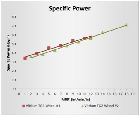

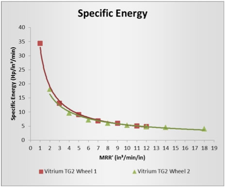

In the tests conducted at the Higgins Grinding Technology Center as the removal rate was increased power increased as well but the power required to remove a cubic inch of material decreased. See graphs 1 and 2.
graph 1
Graph 1: As the removal rate increased, power gradually climbed.
graph 2
Graph 2: As removal rate increased, the energy to remove material dropped significantly.

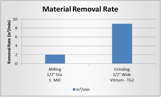

Compared with the removal rate of a typical half inch carbide end mill the rate achieved with the Vitrium³ wheel was about four times as high as seen in the chart below.
graph 3
Graph 3: Removal rates for Grinding with Vitrium³ and ½” carbide end mill
An added benefit of using Vitrium³ wheels is that only a very light burr is produced when compared to standard cutting tools.
figure 3
Figure 3: All slots were ground with a Vitrium³® bonded wheel
except the slot on the right with the heavy burr.

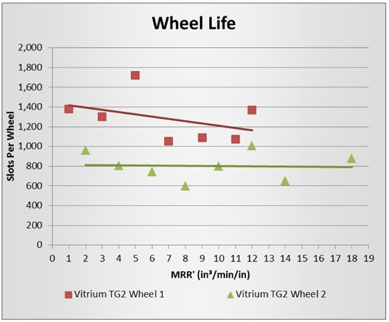

Because the wheel wears during grinding and typically that wear rate increases with increased removal rate it is important to understand how these high removal rates influence wheel life and consequently the cost of a process. The ratio of the volume of material removed to the volume of wheel loss, whether by wear or due to dressing to reestablish form is used to determine wheel life. In the case of the Vitrium³ wheels even at these very high removal rates, wheel life was remarkably stable. Graph 4 below shows how many cubic inches of material can be removed with a single 16 inch wheel. Again if we make the comparison to a half inch diameter carbide end mill and assume it lasts 20 minutes before it needs sharpening it will remove about 40 cubic inches of material whereas a 16 inch wheel will remove 350 to 400 cubic inches before it needs to be replaced.
graph 4
Graph 4: Wheel life accounts for wheel wear during grind plus,
the dress amount required to restore form.
