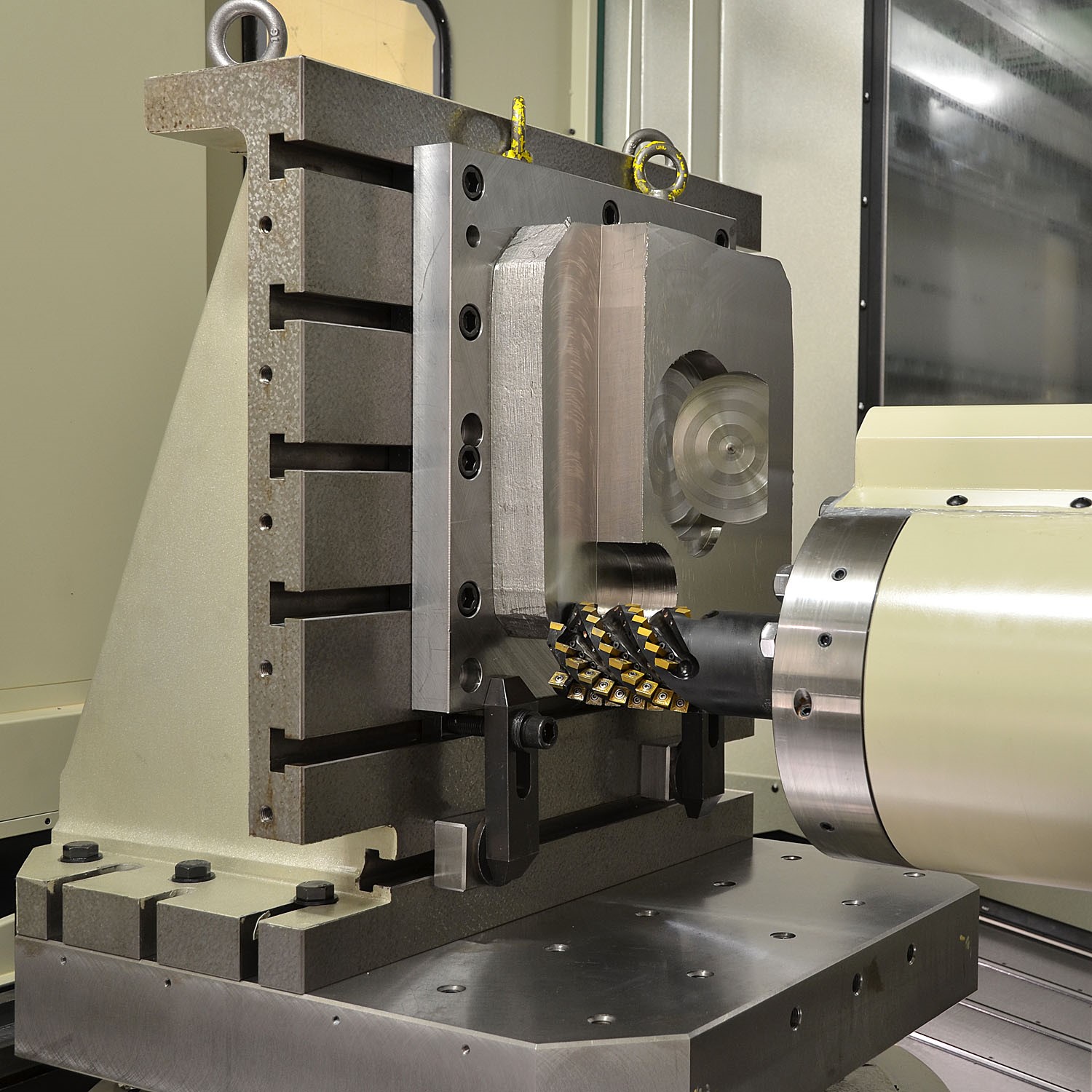

A Mitsui Seiki 5-axis trunnion horizontal machining center machines a titanium aerospace component. Image courtesy of Mitsui Seiki

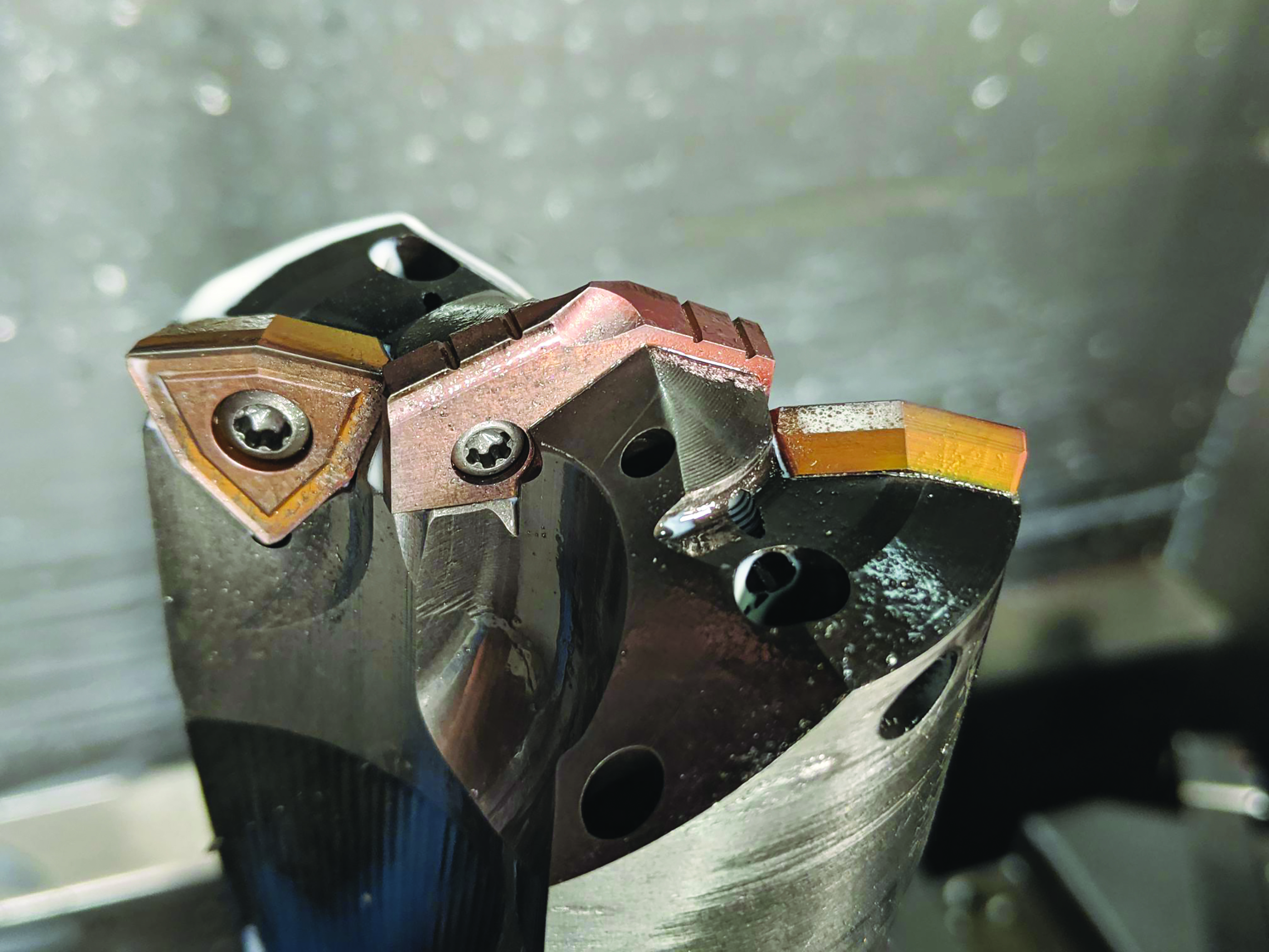

During tool life testing at a customer’s facility, this 2.5″-dia. drill produced six holes per T-A insert for a total length of 90″ and two to three holes/edge with a –PWHR insert or four to six holes/edge with a –PW insert when drilling Timetal 17 (Ti5Al2Sn4Mo2Zr4Cr) with a hardness of 34 HRC at a cutting speed of 82 sfm and a feed rate of 0.0035 ipr. The high-strength, deep-hardenable forging alloy is primarily used for jet engines. According to Allied Machine, chip formation was much better when drilling at 131 sfm and 0.0055 ipr, but tool life can drop if the machining parameters are excessive. Image courtesy of Allied Machine & Engineering
One way to help avoid that problem is by selecting a tool with the proper relief angle so it doesn’t rub the workpiece material. “In titanium, you have the propensity for the material to pinch the side of the drill, so we developed a geometry designed for greater success,” Craine said.
Although that application-specific design requires the drill to run at a lighter feed rate, most titanium aerospace applications, for example, don’t have a need for speed, Craine added. “The material costs are more of a concern. If you can get that job done without damaging the part, then that’s a success.”
In addition to the relief angle, a drill must have the correct rake angle and hone to effectively cut titanium, noted Kevin Vanderbeck, East Coast field engineer for Allied Machine.
However, producing a cutting edge with the correct hone is a balancing act, according to Craine. Too much of a hone and the tool performs like it is dull, while an edge that is too sharp is prone to chipping.

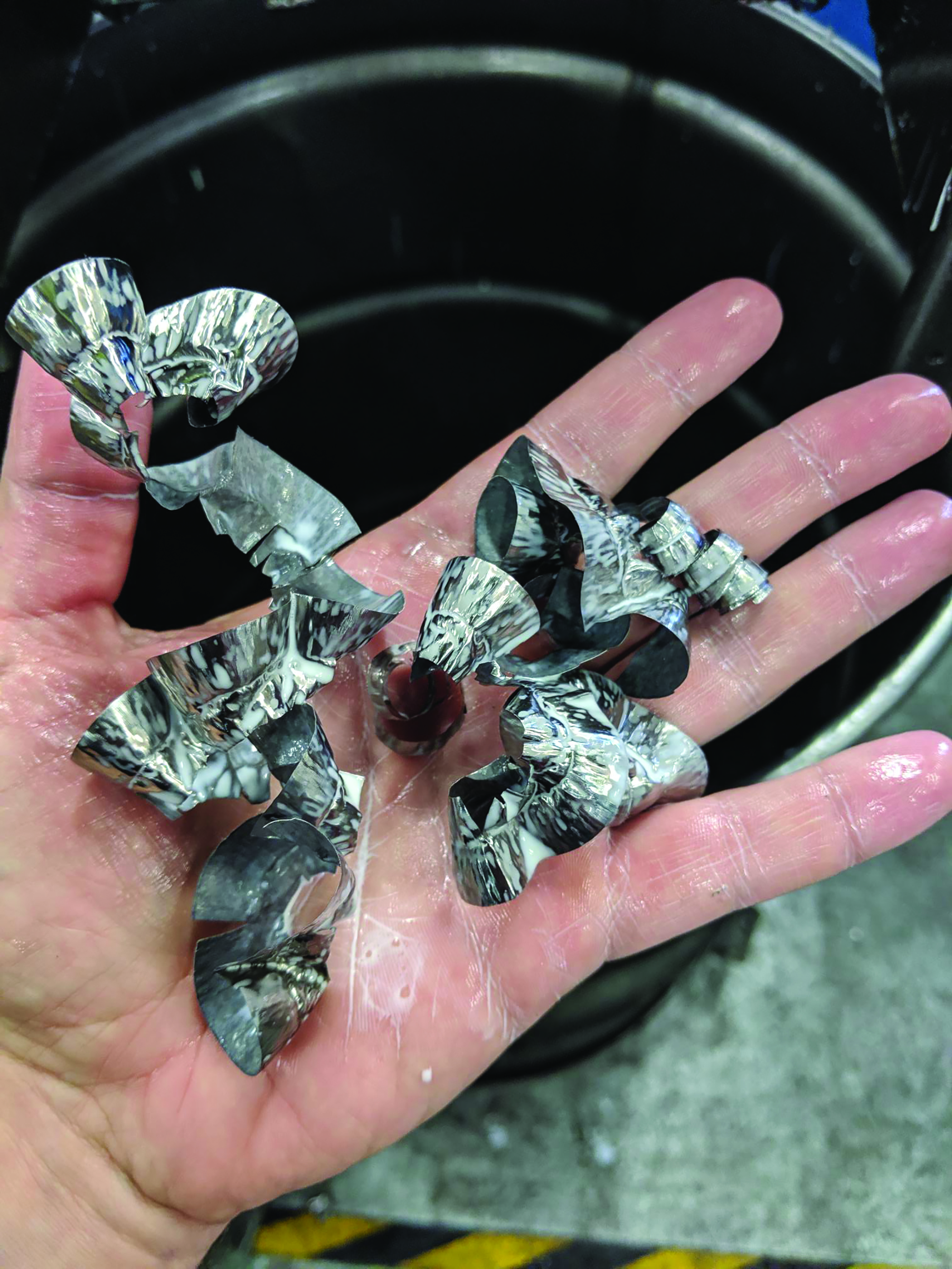

Without proper chip formation, titanium chips can become like ribbons and hard to evacuate. “If you are drilling anything more than three times diameter, that long ribbon will bind up and seize your tool,” Vanderbeck said. “It goes bad real quick, and a lot of times you don’t have time to hit that e-stop. By the time you see it, it is too late.”

The combination of a rigid machine tool and a strong spindle connection is ideal for cutting titanium. Being able to precisely machine titanium at maximum removal rates requires close attention to the machine tool, the tool/workpiece interface and the spindle connection—the “handshake” between the machine tool and the toolholder. Image courtesy of Mitsui Seiki

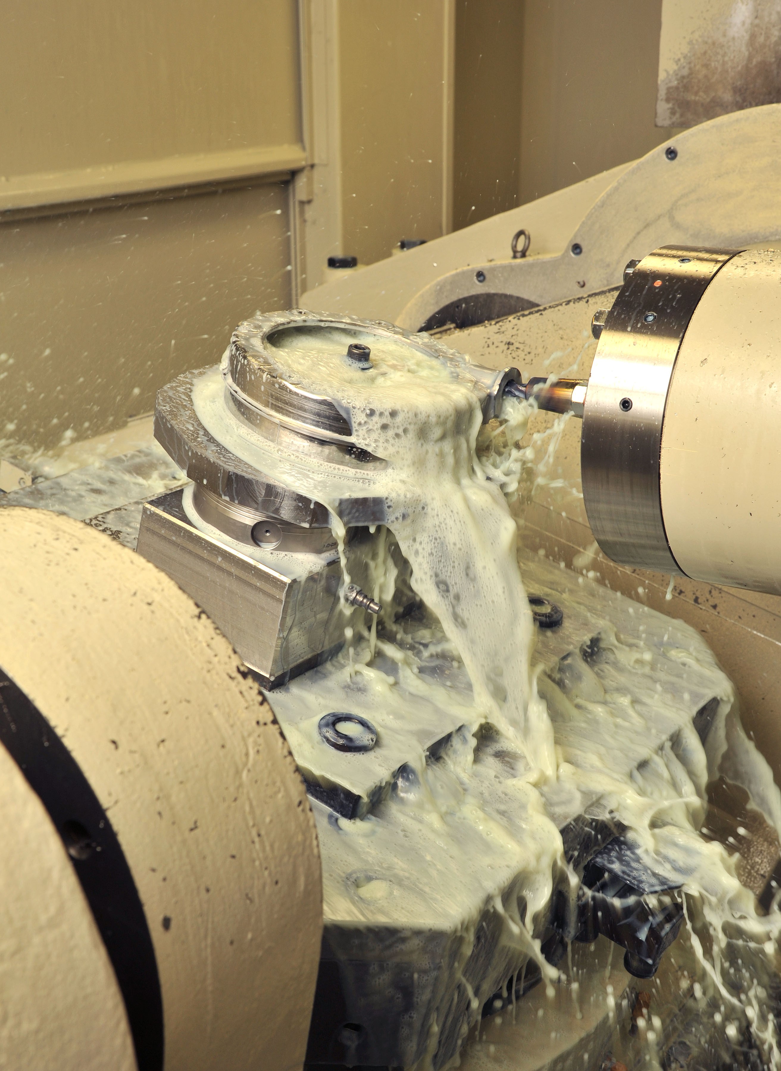

But without an ample supply of coolant, even the most heat-resistant coating will struggle. “The more coolant you can get, the better,” Craine said, adding that it must be a water-soluble solution instead of oil because titanium is flammable. For that same reason he also recommends that the coolant be delivered through the tool. “I’ve drilled a one-times-diameter hole with flood coolant, but that is as deep as I would go in most circumstances.”
Although one East Coast manufacturer running straight oil as coolant didn’t have problems with flammability, the company definitely wasn’t achieving optimum results. Oil is necessary for lubricity and reduction in friction, but water is also important as it pulls remaining heat away from the cutting zone.”
Once Vanderbeck’s New England-based customer switched to a water-soluble coolant, it achieved longer tool life than when the company originally had started using straight oil, he added. “Tool life is much longer and more stable, and their chiller isn’t working as hard as it once was when they used oil and struggled to manage the dissipation of the heat.”
Vanderbeck pointed out it’s essential to maintain coolant at the correct concentration, which is a bit higher for titanium applications. “I strongly recommend that manufacturers consult their coolant supplier for the best coolant concentration for their titanium applications.”

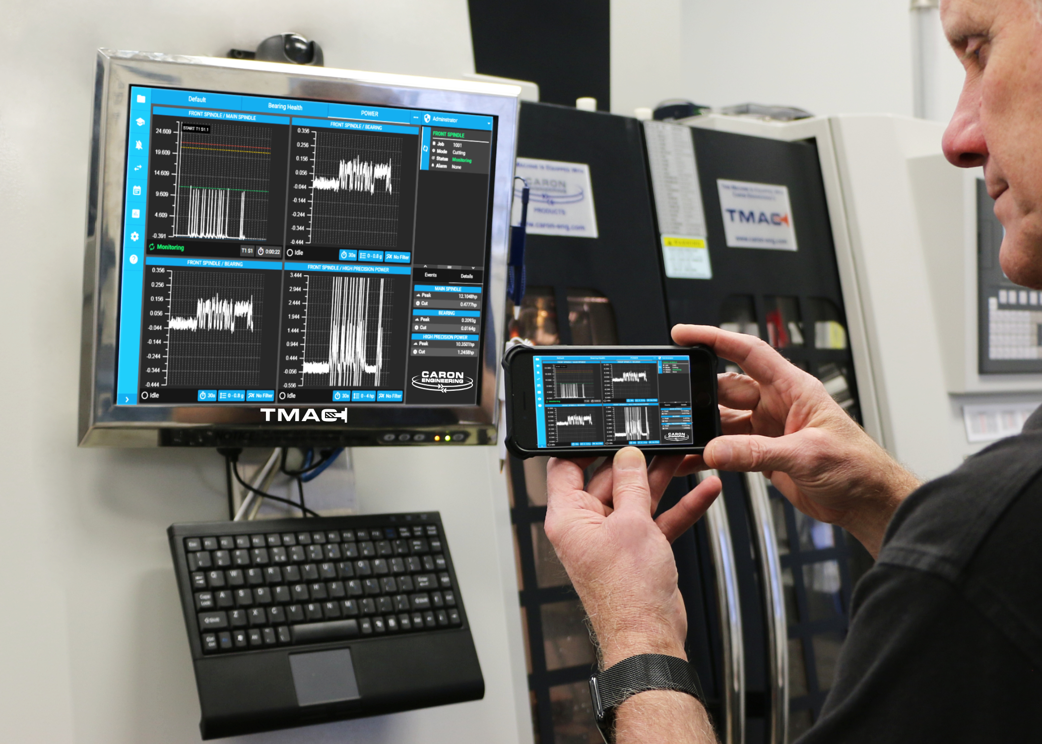

A monitoring system Mitsui Seiki installs on its machine tools is Tool Monitoring Adaptive Control from Caron Engineering Inc., Wells, Maine. TMAC monitors the spindle drive, and an increase in power indicates tool wear, said President Rob Caron. “We also do adaptive control, so we can take over the feed rate and achieve a constant power cut by modifying the feed rate in real time.”
He explained that the system monitors “true power” instead of current to provide a more linear signal over the range of the spindle motor load and function as a more accurate indicator.
“If the motor is lightly loaded, with current you don’t get a very linear signal or a very good representation of what is going on,” Caron said. “It’s much better when the motor is heavily loaded. By monitoring true power, your signal is absolutely linear whether you are monitoring a light cut or a heavy cut.”
By continuously monitoring the power drive, the system reduces the feed rate only when a cutting tool starts to load up or degrade or when the material thickness or hardness increases, Caron said. “So whenever we can go faster, we will, whereas without the system the customer has to program basically worst-case scenario, never knowing when a thicker or harder spot is going to happen or when the tool is going to break down a little more.”
Feeding higher when appropriate enables end users to reduce cycle times. Caron Engineering doesn’t provide any guaranteed reduction but reports that it ranges from 20% to 60% with TMAC. “In the titanium area, it is rare to ever see under a 30% reduction,” Caron said. “The cycle time reduction gets higher as the materials get more challenging.”
