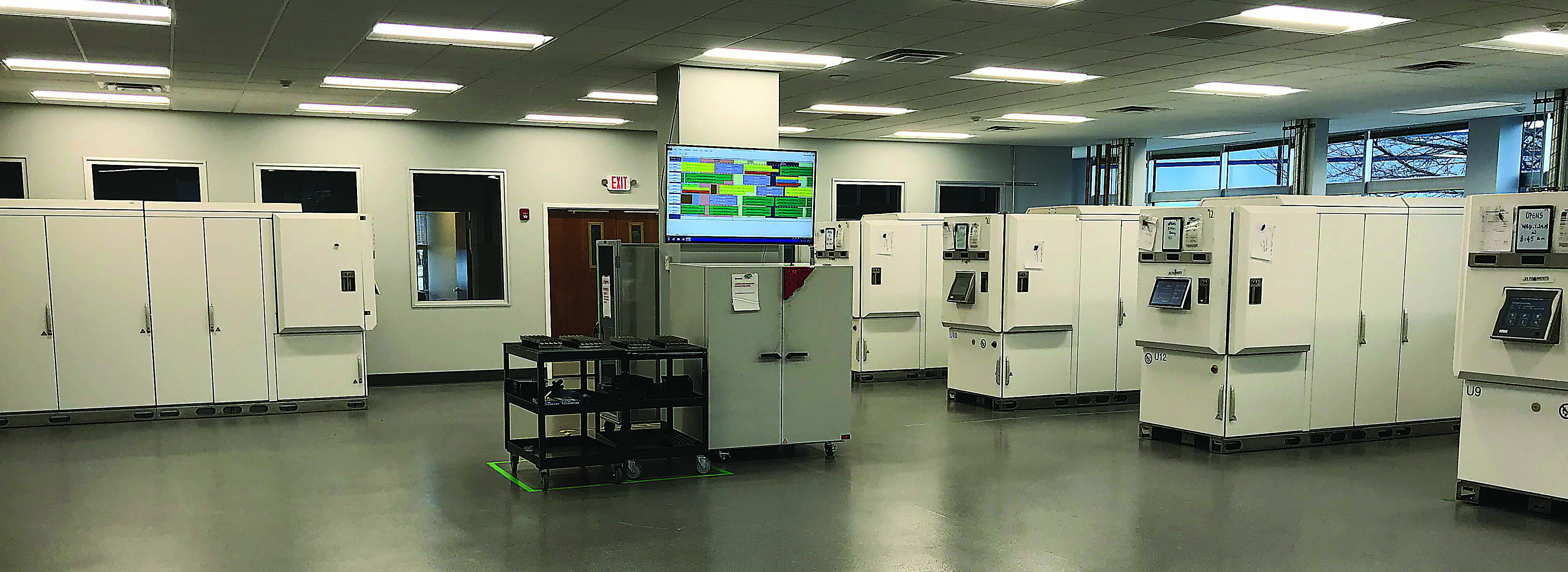

CemeCon relocated its CVD coating equipment to its new building. Image courtesy of CemeCon.
The new building joins the company’s 25,000-sq.-ft. facility in the same Big Flats complex. With CVD-diamond production relocated to the new building, the larger building will continue to house CemeCon’s equipment for PVD and high-power impulse magnetron sputtering (HiPIMS) PVD coating technologies.
“We can add 75 percent to our PVD and HiPIMS business because of the area that was vacated by the diamond process,” Lake said, adding that the company is in the process of ordering another HiPIMS machine. “We have enough space that we could easily go up another five or six machines. That’s a big deal.”
