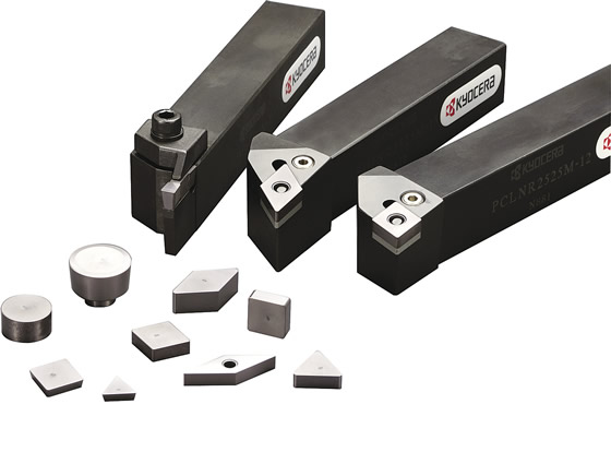

Kyocera.tif
The majority of machines are capable of running ceramic tools, but the difference between success and failure is often related to stability. Image courtesy Kyocera Precision Tools.

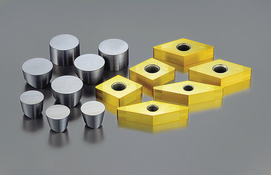

NTK Cutting Tools USA released its aerospace-grade BIDEMICS for machining high-temperature alloys at high speeds while extending tool life and imparting fine surface finishes. Grades include JX1, with up to 1,600-sfm speed capability, longer tool life and better wear and notching resistance vs. whisker-reinforced ceramics, according to the company. Additionally, the JP2 grade is for machining at speeds 10 to 15 times faster than carbide and includes a strong brazing technology. “If customers don’t have high-speed machining, they can look at BIDEMICS as a productivity upgrade, featuring two to three times better tool life,” NTK’s Neal Buschmohle said. “If they already have HSM, they can go from 800 to 1,600 sfm and get two parts out the door for every one part they did before.”
BIDEMICS_JX1%2bJP2_2400pix.tif
R&D has paved the way for new ceramic materials and coatings, like NTK’s aerospace-grade BIDEMICS, that will have a greater impact on high-speed machining. Image courtesy NTK Cutting Tools.
