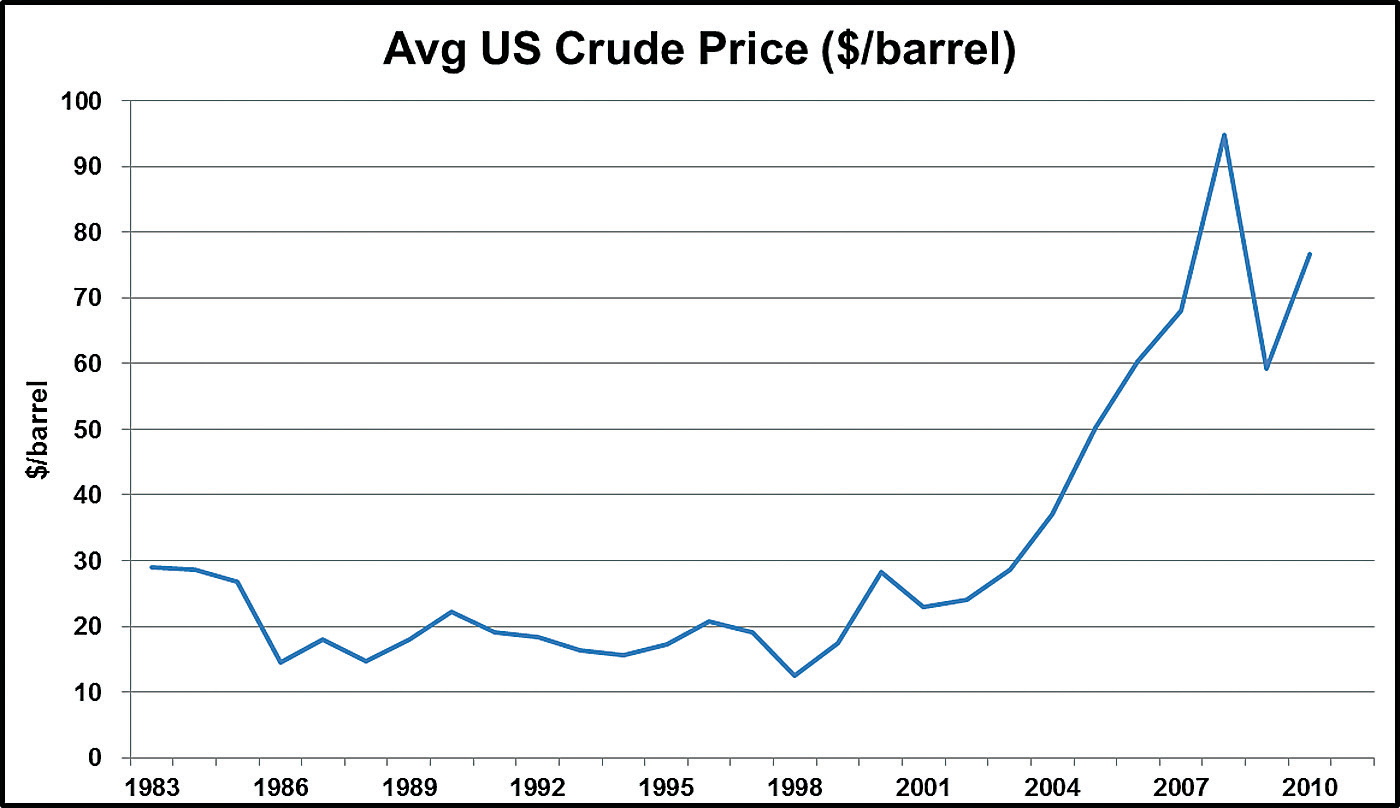

Over the last 30 years, energy prices have risen significantly. Crude oil prices have risen 300 percent since 1983, according to the U.S. Energy Information Administration (see graph on page 65). The sharpest increase has been over the past 10 years.
