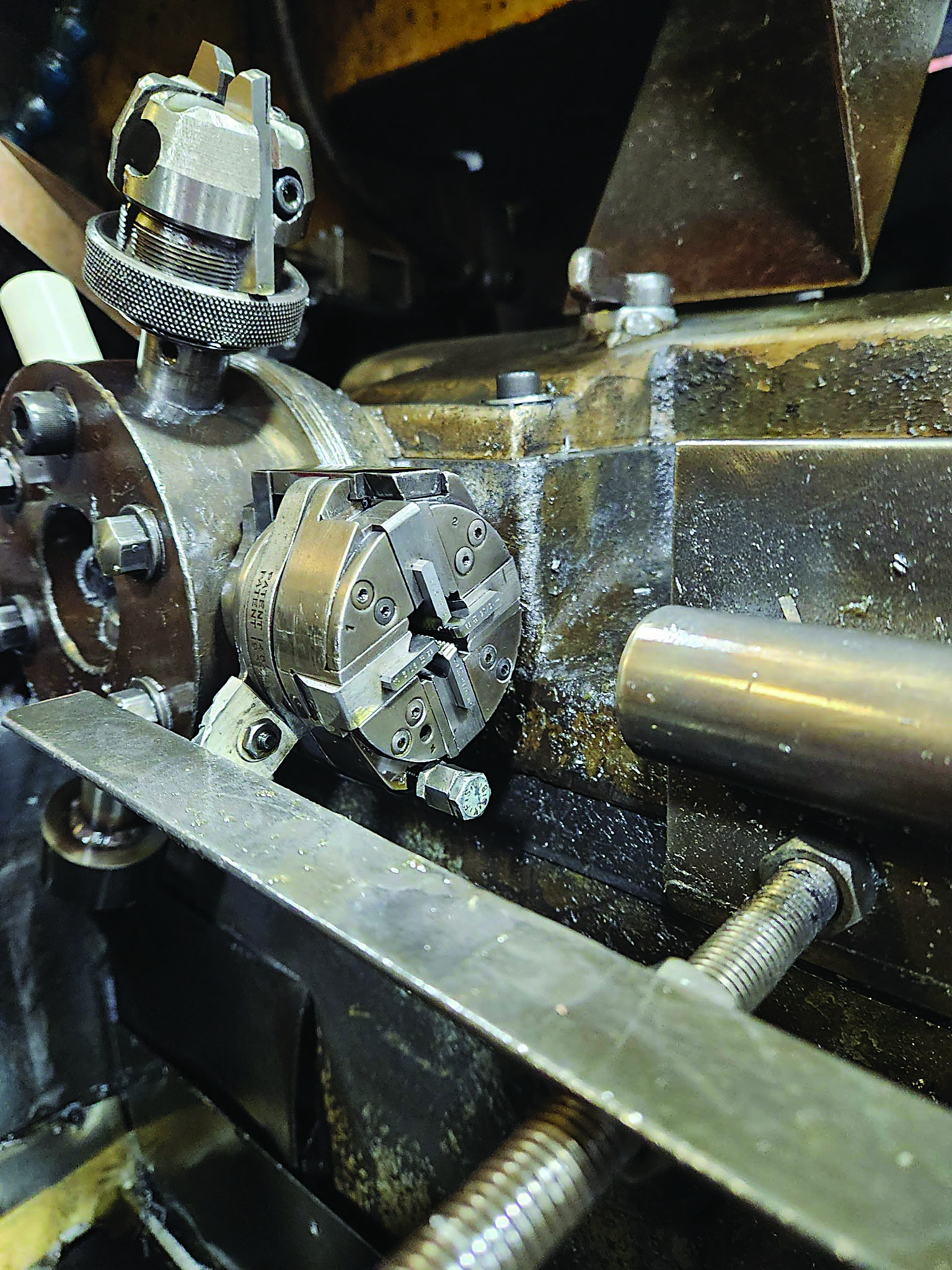

He said Concept Metals Group produces about 50,000 of those shafts per year, which require 5/16″-8 threads on the ends of them. The manufacturer threads them on a manual Brown & Sharpe cam- and gear-driven screw machine. The parts are made with 12L14 or 1215 steel.
Schwierking said the thread chasers that Concept Metals Group was using had unacceptably long lead times and an inflated price tag. The company needed a better option.
“I just started to try and find other companies that were making chasers that could be delivered in a reasonable time, not 16 to 18 weeks, and they weren’t going to charge us three to four times normal pricing,” he said.
The die head is displayed in a manual Brown & Sharpe screw machine.
The die head is displayed in a manual Brown & Sharpe screw machine. Image courtesy of Concept Metals Group

Schwierking requested and received chasers to test. He tried the first style on the Brown & Sharpe machine and said he noticed go/no-go inspection gauge issues in which either the “go” wouldn’t go on or the no-go would. In addition, there were finish problems, such as thread tearing and “hairs” on the threads.
“Your inserts need to be cutting freely and accurately in order for the gauging to work,” he said.

Confident that Quality Chaser wouldn’t give up, he worked with the toolmaker to suggest modifications to cutting geometry, such as the relief angle, clearance angle, chipbreaker and hone. He said Denny Kubczak, sales and service specialist, is his main contact there.
“We just (kept) working with him and giving him feedback for what was going on with the insert so that they could make some adjustments and then give us another iteration to try,” Schwierking said.
A week or so after providing feedback, he said a new iteration would arrive.
“They were responding pretty quickly considering, I’m assuming, they had a schedule that they needed to meet, and I didn’t expect them to cut in all the time,” Schwierking said.
After a little more than two months and testing four or five iterations, he said Concept Metals Group had the thread chaser that it needed with no gauging or surface finish issues.
The threading cycle time is the same as when applying the original chaser, and tool life is comparable — “maybe even better,” Schwierking said.
