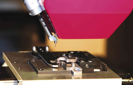

The working environment of the Spectra laser machining center features modular clamping and a 3-D measuring probe for positioning the workpiece.

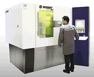

The Spectra 820 laser machining center from Wendt uses a stationary diode-pumped, solid-state laser and oscillates the workpiece to the light source to achieve material-removal rates and impart surface finishes similar to finish grinding. Unlike grinding, where parameters such as wheel diameter or wheel speed are continually changing and interacting with each other, Wendt says the laser machine’s parameters are predictable and do not interact with each other.

However, bigger is not always better. The size of the laser must also complement other attributes of the machine platform and the profile’s tolerance and finish requirements. The Spectra 820 laser machining center from Wendt GmbH, Meerbusch, Germany, utilizes a high-focal precision laser to achieve a focus diameter of 20μm. This means it creates a cavity about 20μm in diameter and 10μm deep. The cavity depth, which can influence surface finish, can also be controlled by manipulating the laser’s pulse pattern. The pulse pattern is manipulated by Wendt’s “Nano-Spot-Technology” algorithm that varies the X-, Y- and Z-axis movement, depending on the characteristics of the form profile.
Pulse frequency and pattern control the mrr. Because each light pulse vaporizes a small piece of material, a high pulse frequency results in a high mrr. The Spectra has a program-controlled pulse frequency between 0 and 100 kHz and typically uses the full frequency range to impart a fine surface finish. The surface finish is a function of the frequency and the axis movement, with both being adjusted depending on a tool’s geometric requirements.
The profile or chipbreaker geometry has a significant influence on mrr. The Spectra is programmed to use a “meandering” technique to remove material. With this technique, the workpiece moves under the laser beam in a linear path along the Y-axis (front to back). When the end point on the profile is met by the laser beam, the workpiece will index across the X-axis to the next row and begin a path along the Y-axis (back to front). The workpiece continues moving row by row until the entire surface has been machined. The laser will then index down the Z-axis to the next level for machining.
In simplified terms, the workpiece begins meandering row by row as the laser moves step by step deeper into the profile until the form is fully created. If the profile has an island, typical of many chipbreaker designs, optimized material-removal strategies are applied to reduce cycle time. Typical strategies include “jump function,” which jumps over island webs when this path is shorter than machining around an island web, and “short way,” where the software plots the shortest path through geometric elements even though the operator’s program path may be different. These functions are automatic when enabled.
