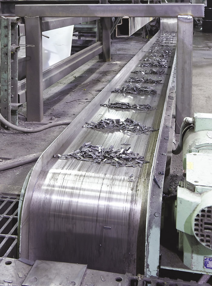

An Eriez magnetic conveyor moves punch-press scrap. Image courtesy of Eriez.

Therefore, customers must look at the big picture and plan for future expansion, emphasized John Mackowski, metalworking product manager for Eriez, an Erie, Pa., manufacturer of magnetic conveyors for transporting ferrous chips and parts. “That’s what most customers tend not to do,” he said. “They don’t think far enough into the future.”
Although determining future requirements can be a daunting task, inadequate planning is especially problematic for an end user with a magnetic conveyor system. Mackowski explained that magnets move inside the housing and each magnet grabs a certain volume of chips or parts. As more chips or parts are produced—for example, transitioning from five machines generating a total of 1,000 lbs. (454 kg) of chips an hour to 10 machines producing twice that much—the magnets are unable to accommodate the increased capacity.
It’s different with belt-style conveyors, Mackowski said. “If you keep piling stuff on top of a belt conveyor, you can increase capacity fairly easily.”
In addition, the width of a magnetic conveyor might need to change as it progresses along its route to where it discharges at the central collection zone. At the beginning of the line, where the conveyor is only being fed by one or two machines, “you might only need a conveyor that’s 8″ or 10″ wide,” Mackowski said. “Conceivably, you can get to the other end of the building and be handling material from 20 machines, so the conveyor is handling substantially more material than it did at the beginning. It’s not a problem, but people just have to understand why you start with an 8″-wide conveyor and, at the end, have a 28″-wide conveyor.”

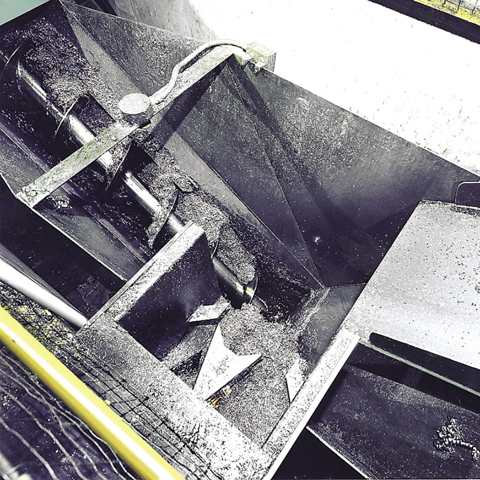

The types of central systems available include in-floor, on-floor and overhead conveyors. An in-floor conveyor is the ideal scenario, according to Titan’s Baumbach, because it can be plated over to make it practically invisible and requires the least conveyor footage because machines typically discharge material close to floor level. However, installing an in-floor conveyor in an existing plant is challenging because a trough must be dug beneath the floor, which requires a significant upfront investment and causes disruption and downtime. It’s also not suitable for a facility that frequently reconfigures its machines.

An in-floor harpoon conveyor automatically feeds a screw conveyor. Image courtesy PRAB.

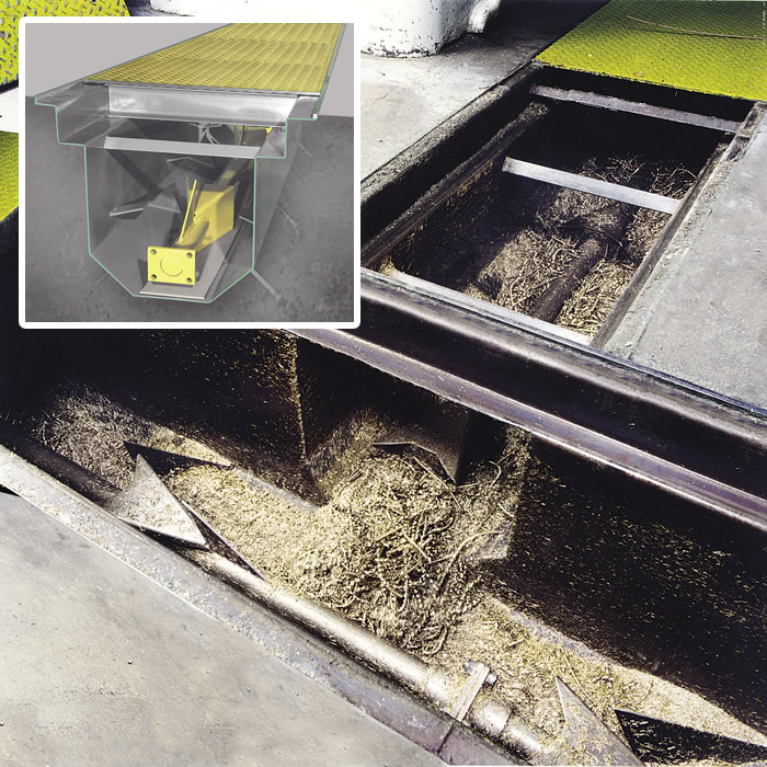

“When facilities are being [designed], customers want to automate and improve their chip handling process,” said Mike Weckerle, OEM sales manager for Jorgensen Conveyors Inc., Mequon, Wis. “The cleanest way to start is before concrete is poured.”

Prab's in-floor harpoon conveyor is engineered to move volumes of metal chips, fines and turnings from the source. The free-floating ram pushes material down the length of the conveyor, and a liquid-tight trough prevents coolant spillage and allows metal and fluid to be recycled. Image courtesy PRAB.
Prab’s in-floor harpoon conveyor is engineered to move volumes of metal chips, fines and turnings from the source. The free-floating ram pushes material down the length of the conveyor, and a liquid-tight trough prevents coolant spillage and allows metal and fluid to be recycled. Image courtesy PRAB.

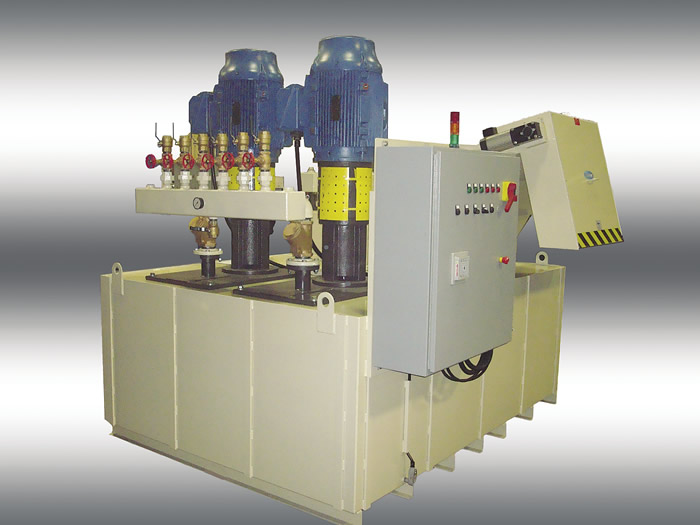

A central coolant chip removal and filtration system from Jorgensen Conveyors is for a Tier 1 automotive parts supplier. It services six Chiron vertical machining centers and processes a coolant flow rate of 360 gpm. Image courtesy Jorgensen Conveyors.
