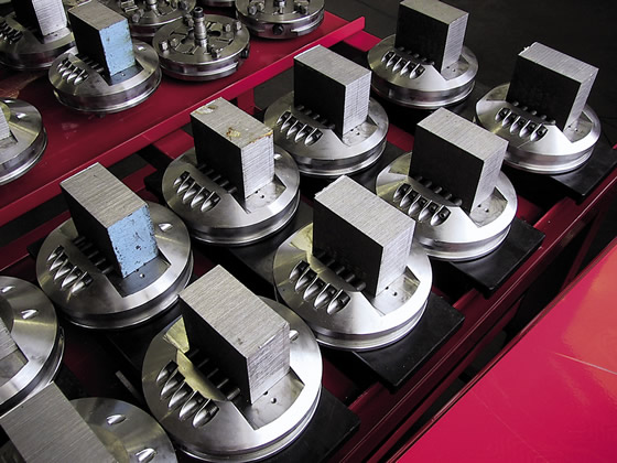

Premachining fixture locations on workpiece blanks can be eliminated with the right EDM workholder. In the example shown, saw-cut blanks are clamped once and gripped until machining is complete. This setup provides a common interface for automated handling while reducing prep time. Image courtesy Erowa.

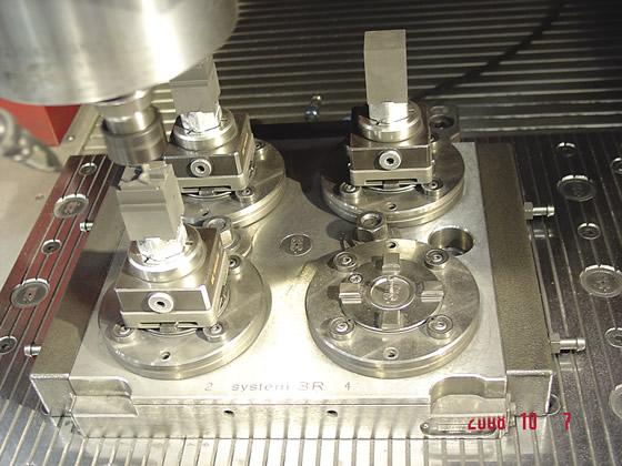

EDM tooling can seem like alien Tinker Toys to those familiar only with conventional machine tools. Much of the confusion about what to order can be avoided by understanding the terminology.

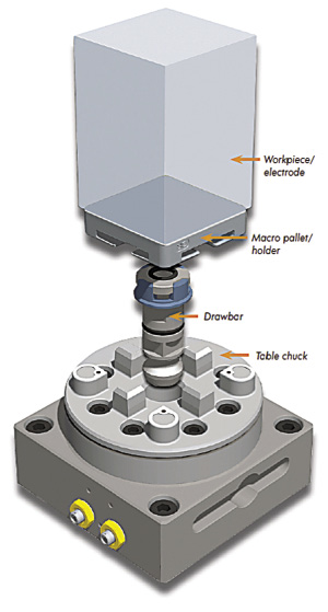

For example, reference elements are rails that mount on pedestals inside the EDM work area. Together with reference stops, they provide a zero point to locate fixtures and other workholding components. Chucks are available in pneumatic and manually actuated versions and accept pallets that in turn accept workpieces and fixtures. Mounting heads are used as the "middleman " between the chuck and a vise or universal holder. Add to that a plethora of adapters, f rames, blocks and clamping heads, and a phone call to an EDM workholding expert might be in order.

Graphite electrodes are machined while held with quick-change chucks from System 3R. Image courtesy System 3R.
Just because the option exists to palletize workpieces in this manner doesn't mean shops are using it. Mike Stevens, applications and technical support manager for tooling manufacturer Erowa Technology Inc., Arlington Heights, Ill., said palletizing EDM electrodes—which reduces handling and increases locating accuracy—is widely accepted in mold and die shops, but that few companies use the same technology with their workpieces.
"For most shops, picking the right tooling system is a basic concept, but how you attach the workpiece to the pallet or carrier can take some thought," he said. Methods include using bolts, magnets, vises and custom fixtures.
The Nano Precision clamping system from System3R
offers pneumatic clamping, accuracy within 0.001mm
and workpiece weight capacity of up to 50kg.
