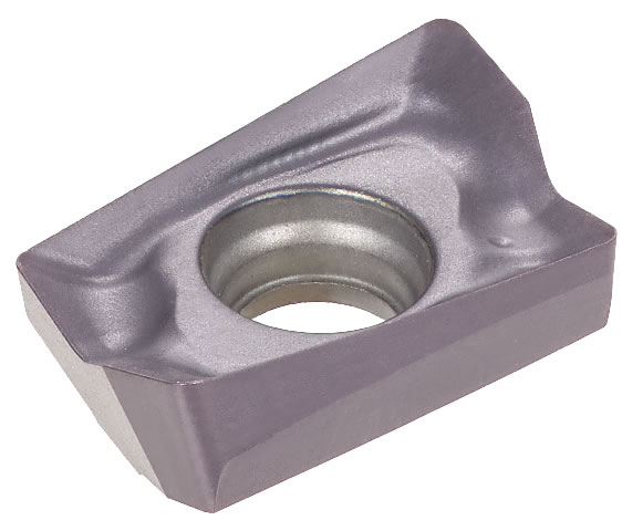

Some insert shapes have advanced to the point where they have a true, 100-percent, 3D geometry with almost no flat surfaces. This requires a tool-body pocket that is dynamically shaped to accommodate the optimal geometry. For example, an insert with a wavelike feature across its back requires it be seated in a pocket with a matching shape to ensure accurate fixation with high stability.

To prevent an insert from rotating in a cutter pocket, a dovetail structure interfaces with the pocket and securely locks the insert on its back face. (See bottom photo on page 60.) As the cutting force hits the bottom edge of the insert, the force attempts to flip the insert. But on the top face of the insert, at the dovetail lock, is a positive stop to resist that force.
With this design, minimal clamping force is required to keep the insert in the pocket. Even if the insert’s clamping screw is engaged relatively loosely, the dovetail geometry prevents the insert from becoming unclamped.

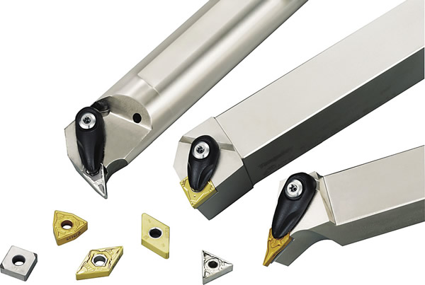

Having a clamping screw in the middle of an insert and a clamp on top of the insert performs a similar function as the dovetail lock, but the time to index an insert drastically increases. (See photos below.) This is because an end user must remove the screw, unscrew and move the clamp, index the insert, reposition the screw and then screw the clamp back into place. This time-consuming indexing activity is unacceptable in a production environment, but even at a job shop, the amount of time spent actuating an additional clamping mechanism can add up.

A wedge clamp can be employed to eliminate the clamping screw. A wedge clamp is actuated from nearly a 45° angle, and it grips the top of an insert without going through its center bore. However, this option is only suitable when machining short-chipping materials, such as cast iron, because a wedge clamp does not provide enough space for chip evacuation when cutting longer-chipping materials, such as steel and stainless.

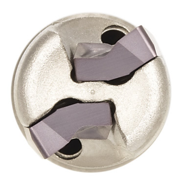

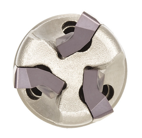

Several benefits are realized by mounting an insert tangentially. For one, because the insert is not extending deeply into the core of the cutter body, the core can be thicker. Essentially, less material is removed from the body during manufacturing, so the body has a stronger base. In addition, the insert is more resistant to fracturing because the cutting force directly targets the longest and strongest piece of carbide. Instead of hammering the thinnest piece of carbide, a tangentially mounted insert twists the cutting force longitudinally along its axis, providing the strength of the full insert width behind it.
Because the insert is mounted from the side, the hole for the clamping screw is larger on a tangentially mounted insert than an insert mounted in the standard style. This is because the full width of the carbide profile is available for placement of a hole and the countersunk area for the screw head, and the larger the screw, the more robust the screw thread and the higher the clamping force. Although other types use this strategy, tangentially mounted inserts utilize it in the easiest manner.
To prevent an insert, such as one in a milling cutter, from becoming dislodged due to centrifugal force, a V shape can be ground into the bottom of the insert. (See photo above.) This provides extra clamping area in the tool body because taking a straight-line bottom and forming it into a V increases the length.

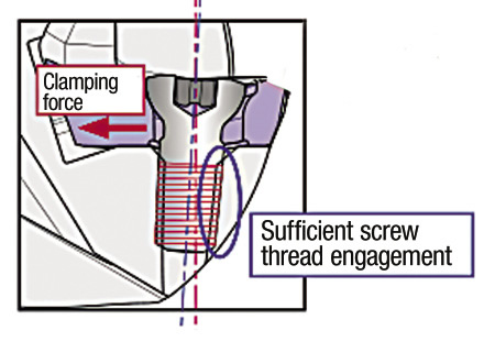

Typically, holes for insert clamping screws are drilled and tapped at a 0° angle. With SS-FiT (Slant Screw Fixation Technology), Tungaloy cants the major diameter thread to the minor diameter hole. Therefore, when an end user engages the screw, it not only pulls the insert against its primary support on the back of the insert, but it also pulls the insert into the pocket.
This arrangement physically deforms the shape of the screw and pushes the thread flanks of the male thread into the valleys of the female thread. By physically deforming the screw, screw-thread engagement increases about 40 percent. It also prevents the threads from disengaging because of vibration, providing somewhat of a shock damper.
