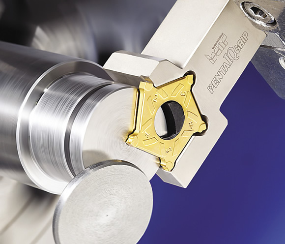

Iscar’s PentaIQGrip parting inserts have five cutting edges and a geometry designed to handle virtually all workpiece materials. Image courtesy Iscar Metals.
The machine itself must be accounted for, but what is done with the machine is more important. According to Clay East, GRIP systems product manager for toolmaker Iscar Metals Inc., Arlington, Texas, tool alignment is the single most important consideration, regardless of the tool or machine.

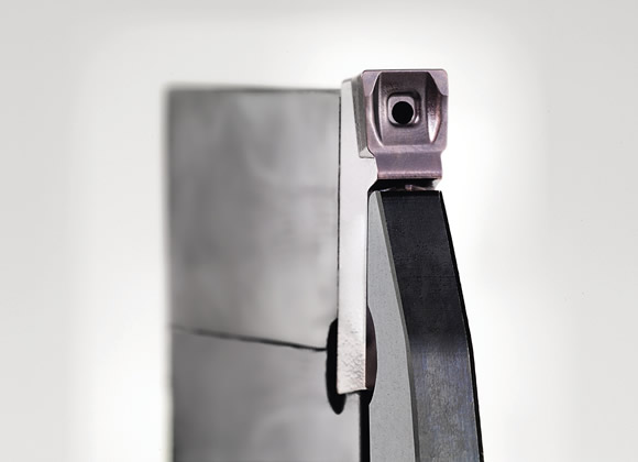

“For cutting off, you should always use the shortest possible tool length,” said Horn’s Carbone. “If you’re cutting a 4 “-dia. part and your tool is 0.0050 ” off center, that might not be as big of a deal as when the part gets down to 0.5000 “. That difference becomes proportionally much greater.”
With 4 “-dia. (101.6mm) stock, the insert blade must be at least 2 ” long, which creates a lot of potential for the blade to vibrate and flex. “Don’t go any longer than you have to,” Carbone said.
