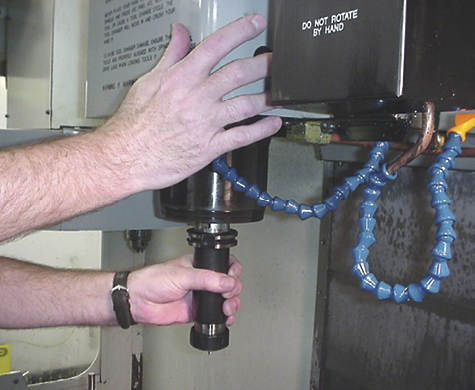

Line up the spindle lugs when installing a tool manually. Image courtesy of J. Harvey.
Type “T1” (or any tool number) with the controller keys. Then press either the ATC FWD or ATC REV button. The tool carousel will cycle T1 into position, and the actuating arm will install that tool in the spindle if it is in the carousel. The machine doesn’t know if a toolholder is in the carousel or not. If T1 is not in the carousel, you can manually install one.
When inserting a toolholder in the spindle manually, it’s important to line up the spindle lugs with the slots in the toolholder as you press the tool release/engage button on the side of the spindle housing.
