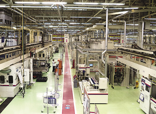

Extending the life cycle of machine tools while minimizing future downtime is critical when producing major components for automotive engines. To achieve that, Fiat Powertrain Technologies do Brasil Ltda. needed to upgrade the CNC systems of machine tools used to produce crankshaft and cylinder blocks at its engine plant in Campo Largo, Brazil, according to Tarcisio Cruz Filho, technical support manager at the plant.
The plant manufactures about 230,000 engines annually and specializes in 1.6- and 1.8-liter E.torQ engines for medium-size cars that can run on gasoline or ethanol. It uses multiple-axis CNC transfer machines, machining centers, grinding machines and custom machine tools throughout its operations. In total, the plant’s crankshaft and cylinder production lines are equipped with 20 key machines, involving more than 120 feed axes, and each machine was originally controlled by a 1050 series CNC from NUM Corp., Naperville, Ill., with NUM’s MDLU1 servodrives and BMH series servomotors.

Courtesy of NUM
NUM is helping to upgrade the CNC systems of vital machine tools at Fiat Powertrain’s engine manufacturing plant in Campo Largo, Brazil.
The average age of the machines was approaching 20 years and, as the machines and their CNCs aged, Fiat Powertrain became increasingly concerned about the likelihood of increased downtime. In addition, troubleshooting the machines and sourcing spare parts, as well as performing general machine maintenance, was threatening to take too long and negatively impact production. This is because some machine components were scheduled to no longer be available as new parts, requiring time-consuming repairs if Fiat couldn’t source an exchange part. Because the machines were fully serviceable, the company made the strategic decision to extend the life cycle of the production lines by upgrading all 20 machines with new CNCs, drives and motors.

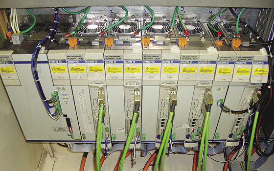

To minimize production disruption, the replacement CNCs had to be engineered in a way that the upgrade could be accomplished as quickly as possible. Using video conferencing, technical teams from both companies established that NUM’s Axium CNC platform provided the least-invasive upgrade option because it used the same architecture as the 1050 series CNC to minimize wiring and software modifications.

The upgrade also required replacement of the servomotors on all the feed axes of the machines. NUM’s BPH series motors were selected as the replacements partly because they have a built-in feedback device to provide higher resolution and the motor mount is the same as their previous series. In addition, the BPH motors have shaft ends, pilot diameters and flange squares physically identical to their earlier-generation counterparts. This simplifies replacement, and the orientation of their power and sensor connectors can be altered during installation to suit the machine configuration.

Courtesy of NUM
The new controllers at Fiat Powertrain are based on NUM Axium CNCs and the NUMDrive C servodrives.
“We allowed for a maximum of 4 days out-of-service time for each CNC machine on our crankshaft and cylinder block production lines,” Cruz Filho said. “Most of the machines have been upgraded and in each case—even on complex machines with seven controlled axes plus spindles—it has taken less time than we allocated. The machines’ diagnostics are now much better, allowing us to perform more efficient preventive maintenance, and our technicians are now familiar with the CNC systems, all of which will help reduce production downtime in the future.”
