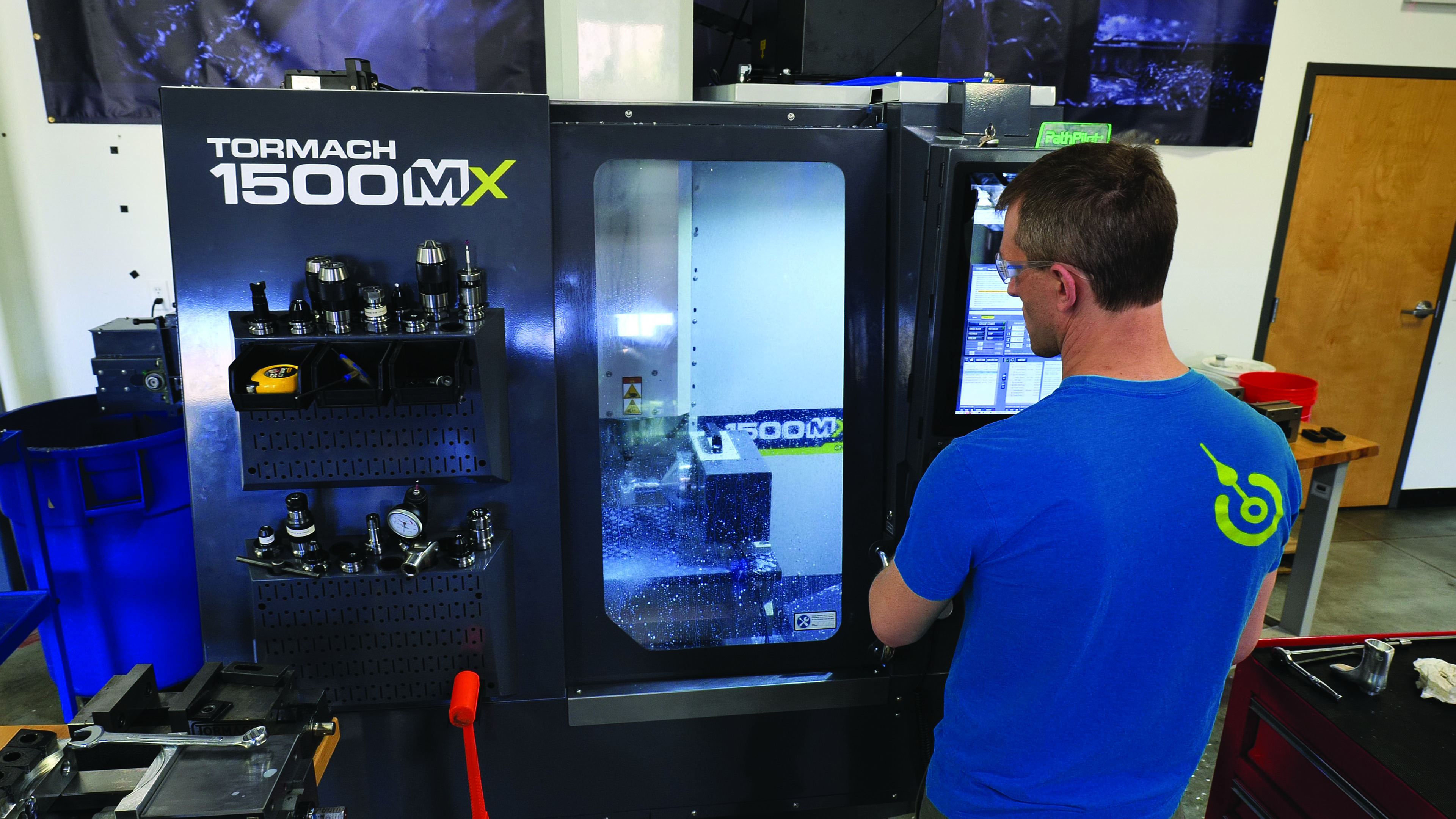

The 1500MX is billed as a low-cost but highly capable CNC mill for prototyping and production.
The 1500MX is billed as a low-cost but highly capable CNC mill for prototyping and production. Image courtesy of Tormach
For motion, the 1500MX relies on servo motors with absolute encoders featuring 23-bit accuracy and battery backup to eliminate the need for machine referencing. “While the machine is shut down, a battery keeps the encoder powered up so the machine always knows where it is,” Rogge explained.
One of the main attractions of the 1500MX is its epoxy granite frame, a first for a Tormach machine. According to Rogge, epoxy granite provides about seven times the damping of traditional cast iron, which can increase tool life by 30% to 50%. “You also get a great surface finish with that technology,” he added, as well as much better thermal stability than that provided by cast iron frames.
