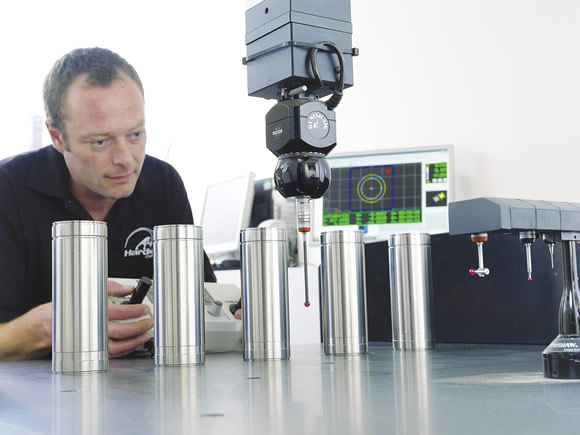

Hardide%20coated%20components%20being%20precision%20measured.tif
Courtesy of Hardide Coatings
A technician measures parts coated with Hardide-A.
The CVD-coated parts have surface finishes as fine as 0.3µm Ra, but can be ground, honed or lapped, if necessary, Zhuk noted.
