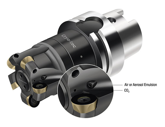

Walter’s Cryo-tec cutting tools, such as this modified Model F2334R milling tool, have two channels: one for applying CO2 and one for applying compressed air or an aerosol emulsion.
Schaarschmidt noted the CO2 and lubricant coolant remain separate until they exit the channel ports on the tool body and mix directly at the cutting edge.
The temperature of the liquid CO2 is about 20° C (68° F) as it travels through the spindle and tool and then drops to -78.5° C (-108° F) when it fuses with the ambient air and becomes a gas and dry ice, explained Fabian Hübner, R&D project manager for Walter.

In a test of cryogenic and air-cooled milling vs. dry machining when producing a turbine blade, the former strategy increased the material-removal rate more than 70 percent. The mrr went from 61 cm3/min. (24 cu. in./min.) to 105 cm3/min. (41.3 cu. in./min.), while lowering the tool temperature from 160° C (320° F) to 40° C (104° F) and reducing the cycle time from 4 minutes and 34 seconds to 2 minutes and 40 seconds, according to the company.
Instead of increasing machining parameters, the user can run at the same speeds and feeds and extend tool life, Schaarschmidt added. For example, compared to wet machining, cryogenic cooling reduced flank wear 25 percent when cutting with the same parameters.
